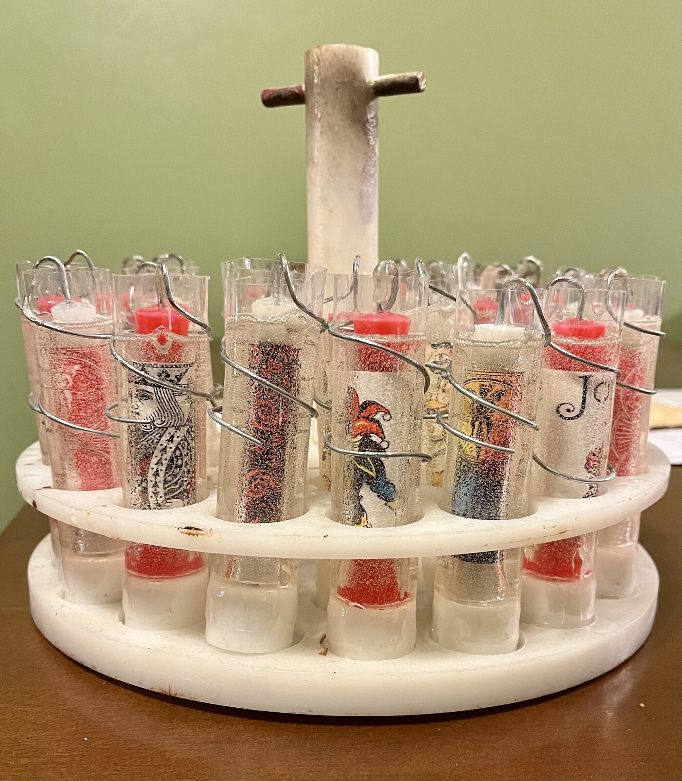

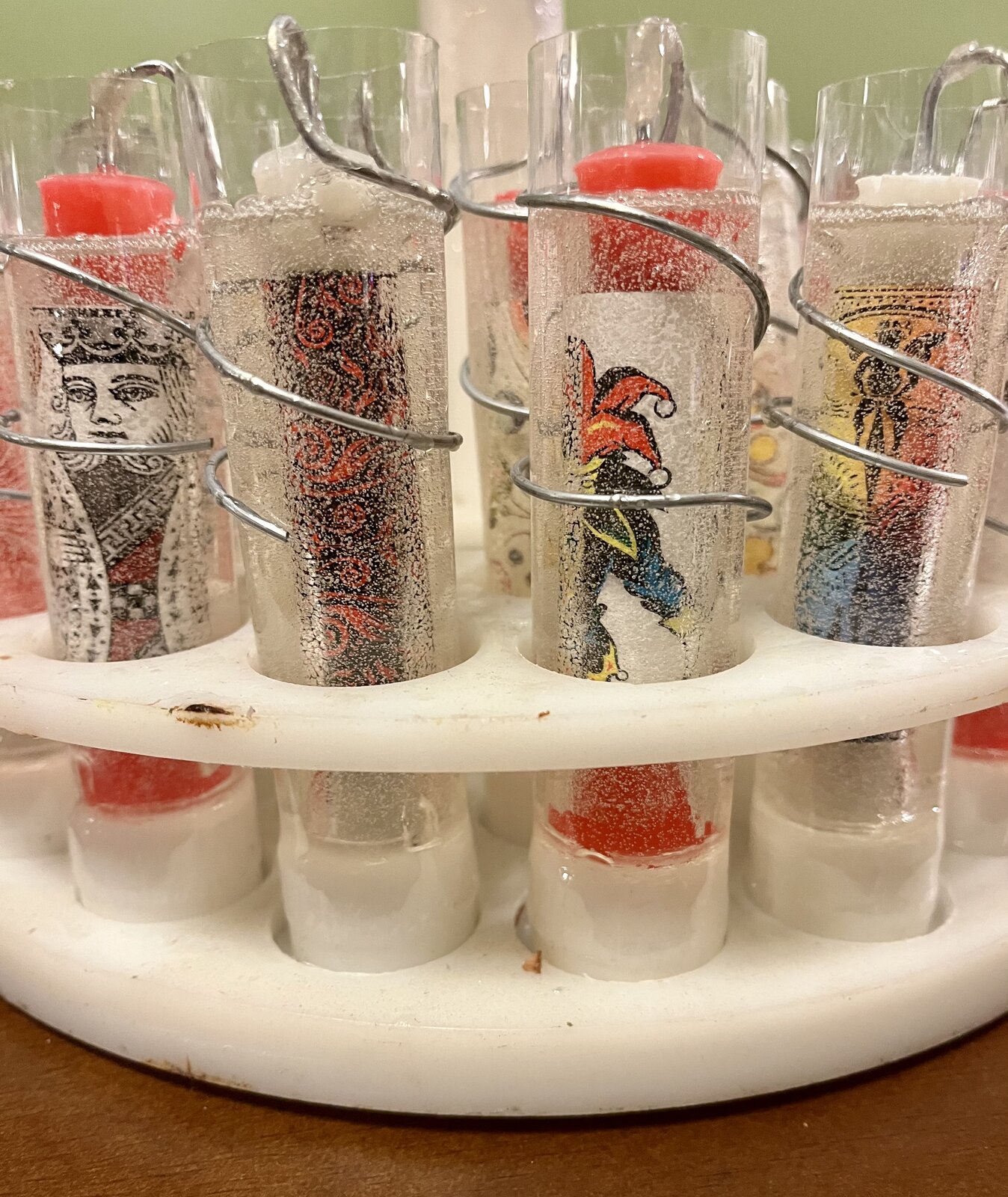

I often have people tell me how nice it would be to be able to make all the blanks they want. Most don't realize or think about the loss of time and money for material when they don't turn out. This month has been one to try my patience. Between the weather and trying new materials, I've thrown away close to 100 tubes.
Today was something different…
After spending a week building (painting, gluing, sealing, drying) tubes to be cast, I thought I was ready to cast. Everything was done as usual and the resin was poured. The problem…. Apparently the compressor motor decided it didn't want to work anymore, and as the clock was ticking… to get the poured blanks under pressure, nothing I did was going to solve that problem.
The end results… 30 blanks I get to demold, throw away and rebuild again.
The lesson… always check to make sure the compressor is working before you mix and pour the resin.
At least I have a nice picture to show why Alumilite Clear Urethane resin needs to be cured under pressure.

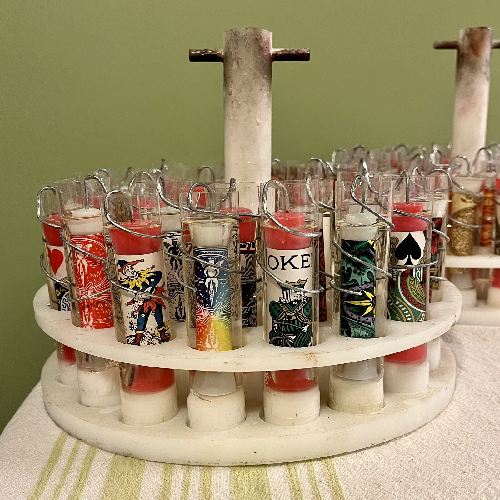

I got home from the holiday family visit about the same time my new compressor was delivered. It's always nice to use tools that work. Lol. Now I can get back to casting. The 4th time was the charm. 😅
