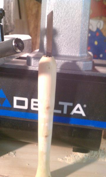

You could also make your own parting tool by turning a handle then grinding the teeth off a jigsaw blade. This gives you a very thin kerf parting tool. This also works great for cutting the CA between your blanks and the bushings after you finish or cutting blanks into slices for laminating.
