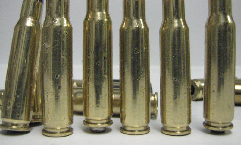

I need to ask. I just bought some bullet shells from someone that said they were polished and powder coated and ready to use. This is how they came. In my eyes they are pitted and not useable. This person agreed to give me a refund but I was angry that they even sold them in this condition. I am now out the postage. Not to mention they were supposed to be for veterans on the 4th. They said they did not understand what the problem was and have sold many of these just like the ones I bought, for $4. or $5. each!?
BTW the photo that was posted did not show the scratches and pits.
My question to you is, Would you accept these as ready to use? Is it normal to have pits in clear powder coating? I needed to ask because I was thinking of getting a powder coating system but if this is the end product I won't bother. Am I being too picky? Is this normal?

Well, if you were offered a refund, and you're not happy with them, take the refund.
As for the scratches, looks like they were there before the clear powder coat went on the rounds. Personally, I think it gives them a 'used' and 'authentic' look that beats the PSI 'fake bullet' pens...but each person will have their own opinion.

I am a reloader and see that in used ammo - New cases do not have those dents and marring. I generally use new cases (the brass part you have).
Used cases, generally picked up off the rifle range - and often military practice/training rounds expect some mars. I suspect those are rejects from a firm that reloads used ammo - I would not reload those personally because of the pits.
They will work for pens, but what you see is what you get -- sell them as used cases or recycled ammo pens.

I would have been disapointed as well. I re-load and those would have gone in the trash, I have used brass for multiple re-loads before, those pits are from corrosion not use. Even the scratches are not from "normal" wear and tear. If they were "special" authentic cases with some historical significance................maybe. Other than that I agree you got took, I'd call it a learning experience,accept the refund, eat the shipping and use more trusted sources and see photos before you buy if possible.

I've only done a little powder coating, but the casings were new and I polished them extensively before putting on the clear coat and they did not look anywhere near like what you show in the picture.
So you are saying it is normal to have pits in the clear coating where there is no coating at all? I am not talking about the scratches. If so then what is the point of clear coating? Isn't it going to tarnish where the pits are?

I think I would have been really pee'd off if I recieved those. I don't know about dents and scratches, they look to me as if the clear coat hasn't stuck down in places. Maybe they weren't properly degreased and cleaned before powder coating.

"Dents" are being mentioned. There are actually no dents in the shells. The round spots you see are "pits" they are places where the powder coating has not stuck
I would have been disappointed also. I have gotten used shells from a couple of people and they had some surface marks that were what I wanted, but no pitting or looking like yours. It does look like the coating is coming off in places. Take the refund. PM me and I will give you the names of the people I have gotten some from that were very nice.
Ouch--------- those look bad.
Looks like there was oil on the brass which caused to Powder Coating to mess up.

Could this be damage during shipping? Were they all thrown together loose in a package where they could have rubbed together during shipping and caused this? That would see to be a logical explanation seeing the scratches as well. They look like they rolled around in a box or something.
No not at all. they were in a bag surrounded by newspaper. I don't think there is any way pits would appear from shipping. The round spots are actual places where the coating did not stick. Alice

The flaws are not damage during shipping. Powdercoating is harder than woodpecker lips. Heck, I even had a terrible time removing the stuff when I tried once just for kicks. The shells should not have even been sold looking like that. The powder coated shell should be smooth and shinny. Scratches and dents from used shells will not be hidden. I polish the ones I do with brasso and then buff and clean them with alcohol as I place them on the rack for coating. Even oils from our fingers will cause the PC to not stick.
Abosolutely spot on, about the only way to get those pits is from corrosion of some sort. New casings you buy for reloading are 99 % of the time sold in bulk bags, 50 or 100 usually just loose in the bag. Any marks from then rubbing together buff out in the tumbler or polish out at least to near unnoticeable degree. I don't powdercoat so I'm not comment on quality or procedure there but I have reloaded many thousands of new and used brass so I feel qualified in saying nothing is "normal" about those pits and scratches.

No, that is not normal. Send them back and ask for a refund of your shipping cost for returning a defective product.
A powdercoated shellcase should have 100% coverage and be completely smooth (unless you are using a wrinkle-paint). There should be no gaps, no pits, no bubbles, no high spots, and no orange-peel. If any of my cartridges came out of the oven with even one such pit, I would strip and recoat it.
Powder paint won't fill dings in the brass, but it will coat them.

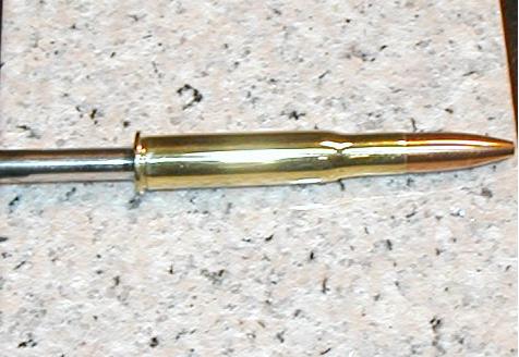

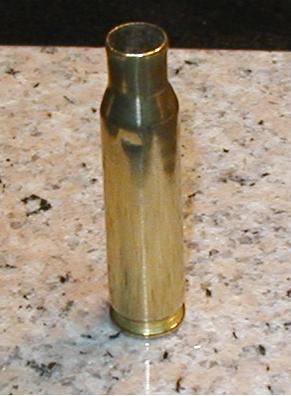

I'm a real novice at powder coating (worse at photography), but here is what mine look like. Pic is fairly accurate. Looking at the cartridge case you cannot tell it is powder coated. Can only tell the difference by feel, powder coated case feels more plastic than metallic feel of raw brass.

I had pretty good luck with Minwax brushing lacquer, thinned 50% and a little lacquer retarder. HVLP sprayer (I think, I may have used my Little Critter sprayer), 5 or 6 coats. Looks good, feels good, just don't know how it will last.
I have used most of the available brass lacquers and several formulas of regular lacquer and the coatings all failed within a few months . If the brass is highly polished there is nothing for the lacquer to bite on to and it will chip and peel . If you acid etch the brass first you can get a durable coating but it don't shine very well .
