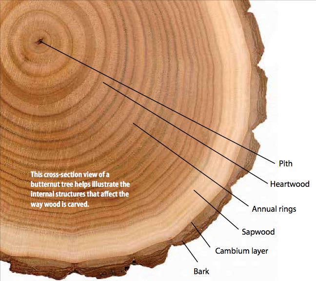

Does this diagram's depiction of "pith" concur with your intended meaning ?
It's a term which has confused me at times, but this diagram suggests it is the extreme central portion of the "log" or "stick".

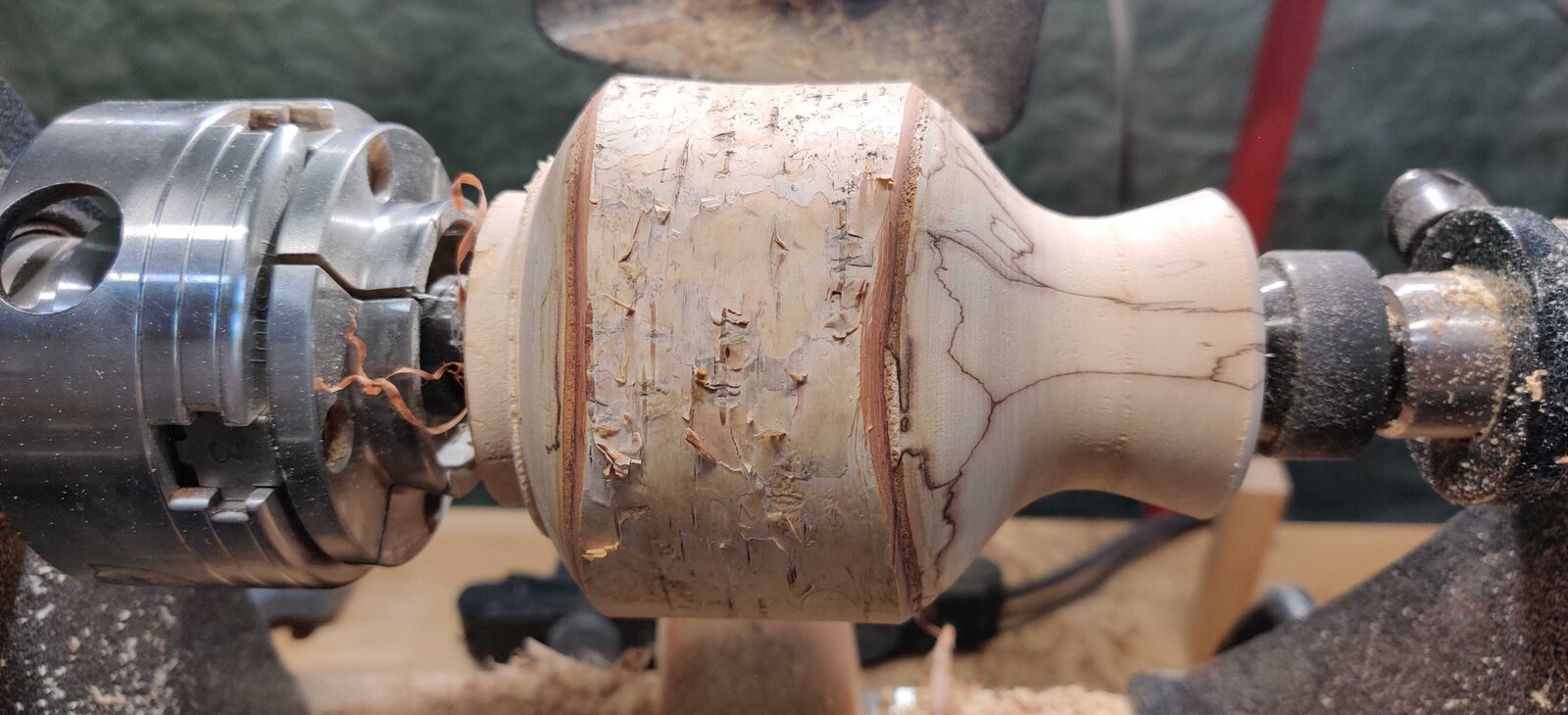

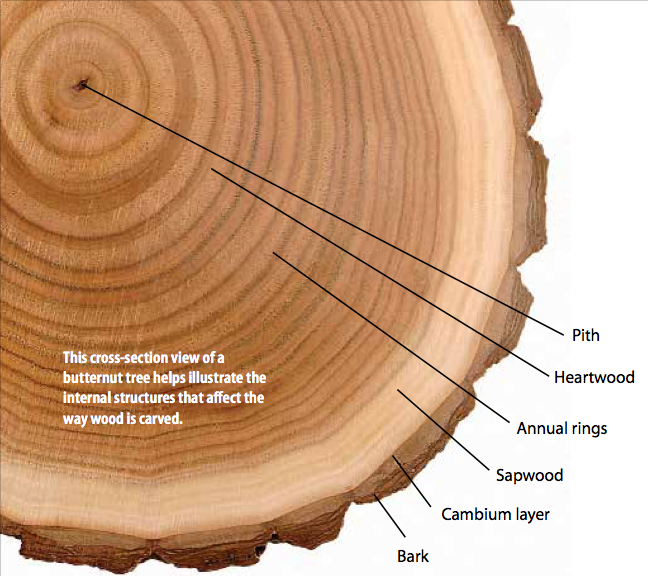

At 2.5" across, if you decide you cannot use it for pens, you could try using it for some small twig pots. I love branches, with bark on, for such little things. I turned some birch branches (I'd say 3" across) not too long ago to do just that:
These can be made pretty small. Great way to use wood (with a pith, even! I haven't had too many problems with that) that you can't find a use for any other way.
