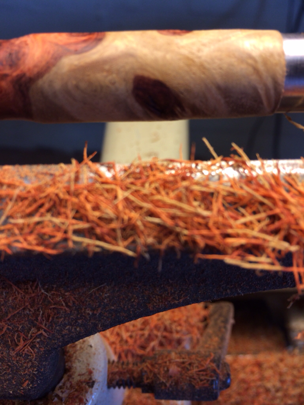

For pens I like using an oval skew. It produces unique shavings in my experience.

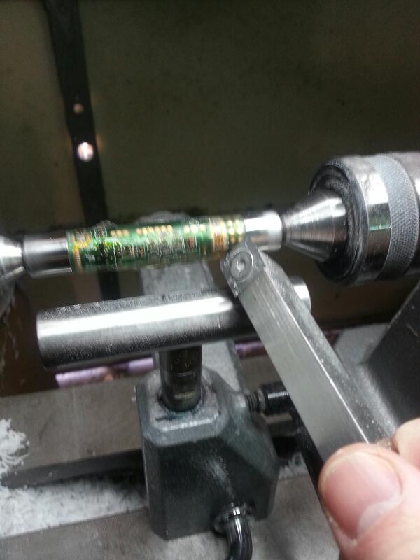

Carbide "square" is best used to SCRAPE. Can be used as a skew but not that simple to master. As a carbide tool seller, I can honestly say that after turning well over 100+ with a carbide tool that I became proficient in using it in this matter. I hold the tool with two hands, my left (to guide) and my right (to lightly apply pressure). The carbide insert is moved towards the blank at an angle. As for angle, try different degrees and turn with what feels "comfortable". I know by "sound" and feel when the tool is performing well. Try it on wood and do not go towards plastic(acrylic) until your skill level increases. Wood is more "forgiving" than plastic(acrylic, etc.). As always YMMV.
The only thing I see in your picture that goes against conventional wisdom is that the location of impact (pressure) is not directly supported by the rest. This leaves a safety hazard of sorts if you catch a snag. However, since the shank of the tool is so narrow, it may not be much of a hazard compared to a large gouge or skew.

I tilt the tool so the blade is at a 45 degree angle (approximately) to the tool rest. I use my skew upside down, too, so my advice is probably not the best.:smile:
Technically, that's called shear scraping. It cuts very nicely. Sorby makes a tool that holds the carbide insert at an angle, like you're doing there, and they call it a shear scraper.
I use it just like Chris. It is not upside down in the picture. He was referring to how he holds his skew. As long as your point of contact is at or above the centerline, as it would be with a skew, the material doesn't seem to care that it isn't a skew.:rolleyes: You can get very sharp radiused-square carbide cutters from globaltooling.net for $2.61 or $0.65 per edge. At several pens per edge, I don't think I will even spend the time to try and hone them. I am still on my first cutter from my December order!
