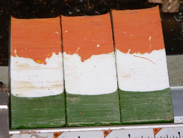

If something like this is what you have in mind I could make some.
Don't know what the shipping overseas would be though.
was looking for something similar to this, i was hoping to get very little of the green and orange into the white as i wanted to get it engraved with either, Èire, a shamrock or harp
That could be done also. All I have to do is pour the next color after the previous has gelled. The question now is, do you want the sections to run lengthwise or crosswise on the pen

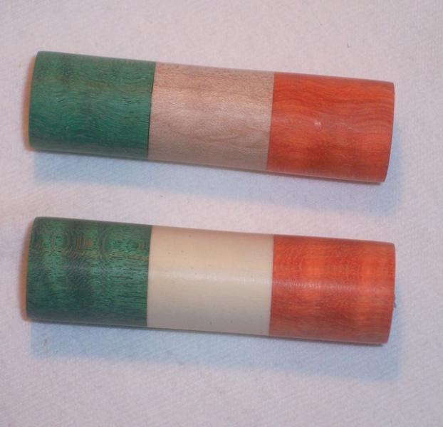

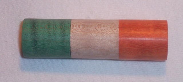

Does it need to be acrylic/poly? Have you considered wood? Here's green, clear, and orange curly maple on a sierra tube...........
And here's another done with Holly instead of clear Maple for the center- gives it a little whiter look. Has the first in the pic as well for comparison.

I don't have a good Irish green on hand. I have attempted to order some several times from artstuf and they were always out of stock. I do have a couple of liquid green dyes that are untried in PR. The orange might also be a challenge, I am rather picky about color match. At least I'm not always happy with the way some blanks turn out...........Maybe a stout or two would help! I take it you want the colors opaque?
I'll make up some prototypes and post them for you. By opaque he means a blank that has a solid color. Some colors come out transparent and as you turn it the tube shows through. These shouldn't, still it would be a good idea to paint the the tube before you glue it in.
