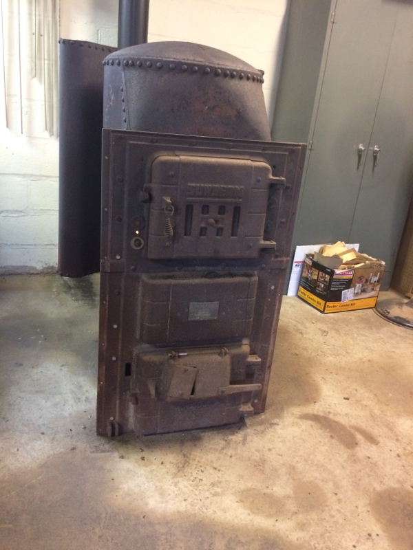

This is the time of the year when many complain about not being able to turn in their unheated shops.
I've turned the last couple years with no heat but in very short bursts. 20-30 mins here and there.
My shop is the size of a 2 car garage with no ceiling and no insulation. Block walls 10' high and then going another 6 plus feet to the peak. Tough to heat right? Yup.

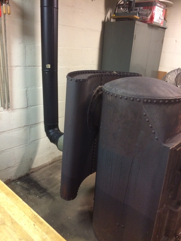

Enter the beast. Guy down the road calls me and asks I I have any heat yet. He's getting rid of an old wood/coal stove for free. Used to heat a whole house and is old an massive and ugly.
Well it's like 25 degrees outside. The shop isn't exactly toasty toasty but I can work reasonably comfortably in s sweatshirt for hours on end if I so choose. :).
Still no insulation and no ceiling.

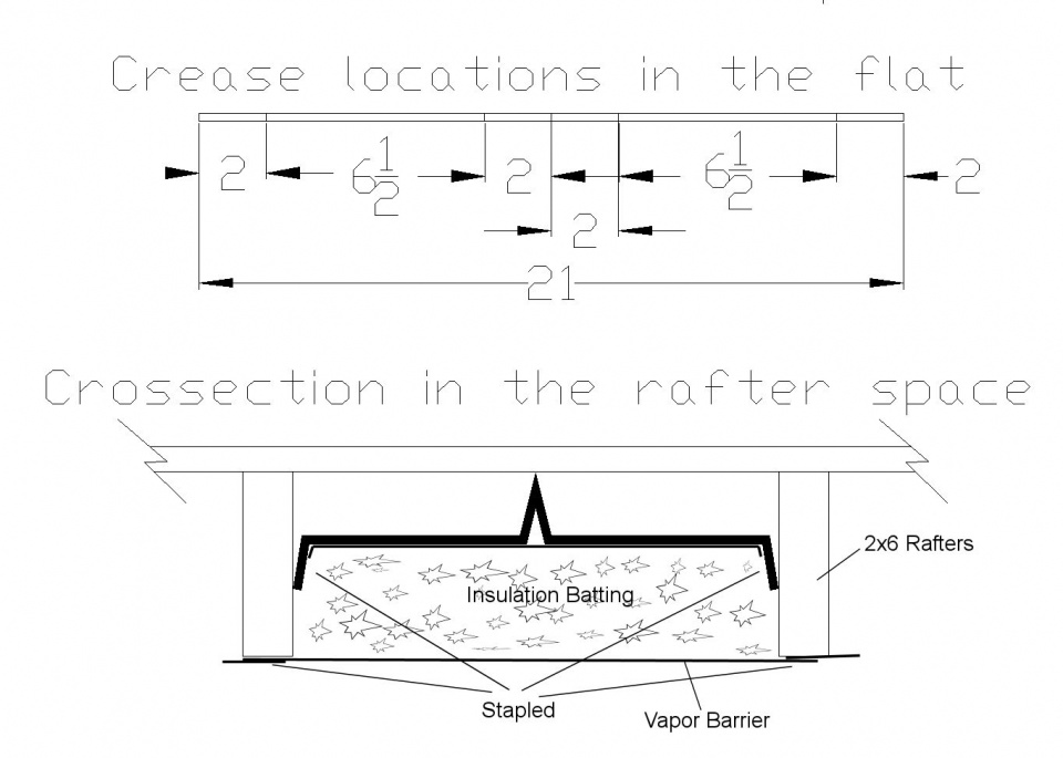

Dan my shop is 2x4 wood frame, 20x32. It has no ceiling, didn't want one, so i insulated the rafters as well as the walls. My only heat is two 1500watt milk house style electric heaters. One is on a t-stat set at 60. Outside temps are running in teens and single digits. Inside temp holds at in upper 50s until I turn on the lights and start using my machines. Within an hour or two the 60 degree heater will start cycling to maintain 60. Said all that to say "yes", insulating the joists will help a bunch. Just be sure to vent between the insulation and the roof sub sheeting.

My Joist Insulation and Ducts
Got a PM asking about my joist insulation and ducts. Couldn't find an attachment function in messaging so I will just post a pic of it here so everyone could see it. Should be self explanatory. The duct runs the full length of the joist from eave vent to ridge vent. I designed the vent from corrugated cardboard and had a local cardboard packaging company cut it to size and crease it at the folding locations. I used about hundred in 4ft lengths.
