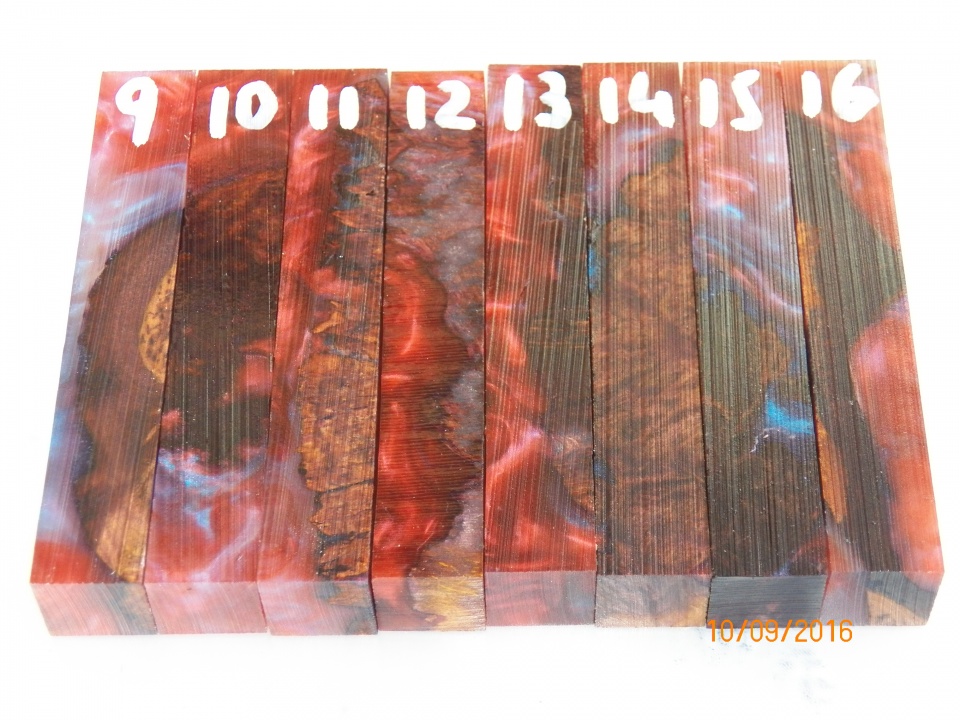

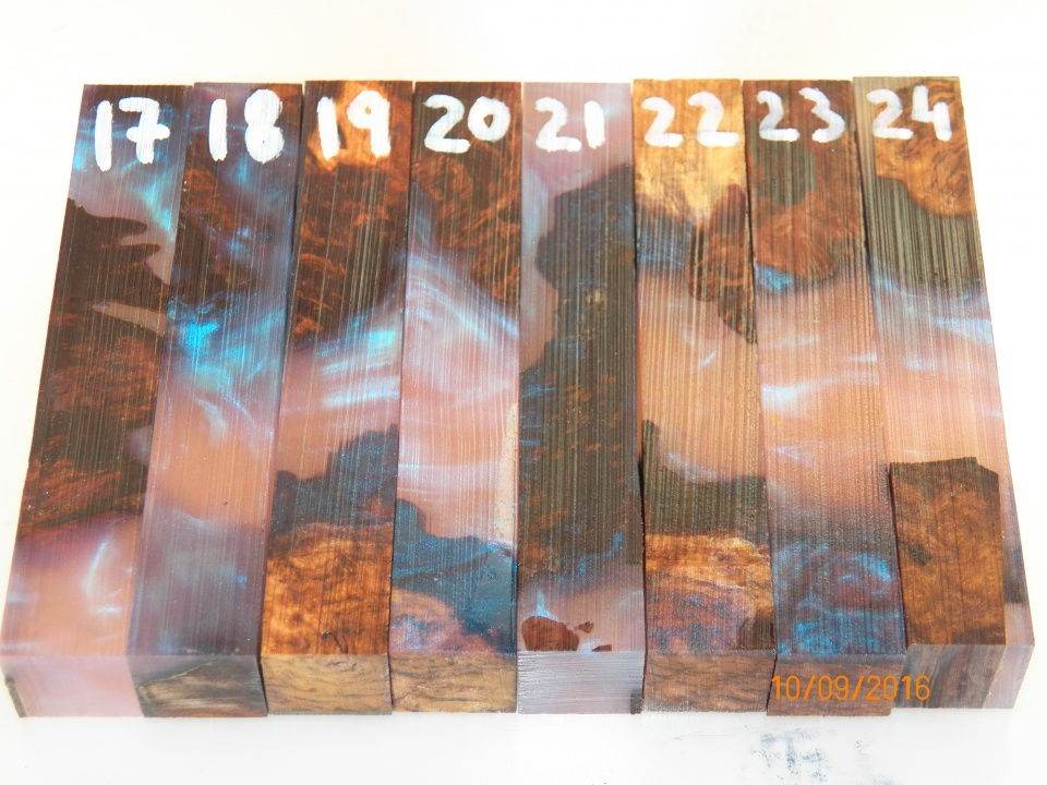

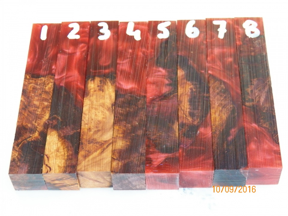

Well, this is not my thread but, I feel I could have shown a couple of pics of blanks I made with the Interference and the normal Pearlex colours and one with a mix of both.
I didn't do it them and I know Camardelle is going to also show some examples to I don't think that will do any harm is showing some examples.
Interference
Regular Pearlex powders
Mix of both
Hope this becomes a little more "clear" now:)
