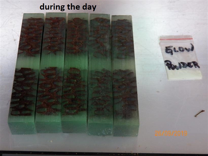

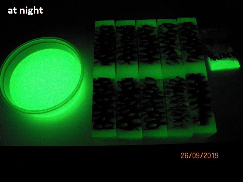

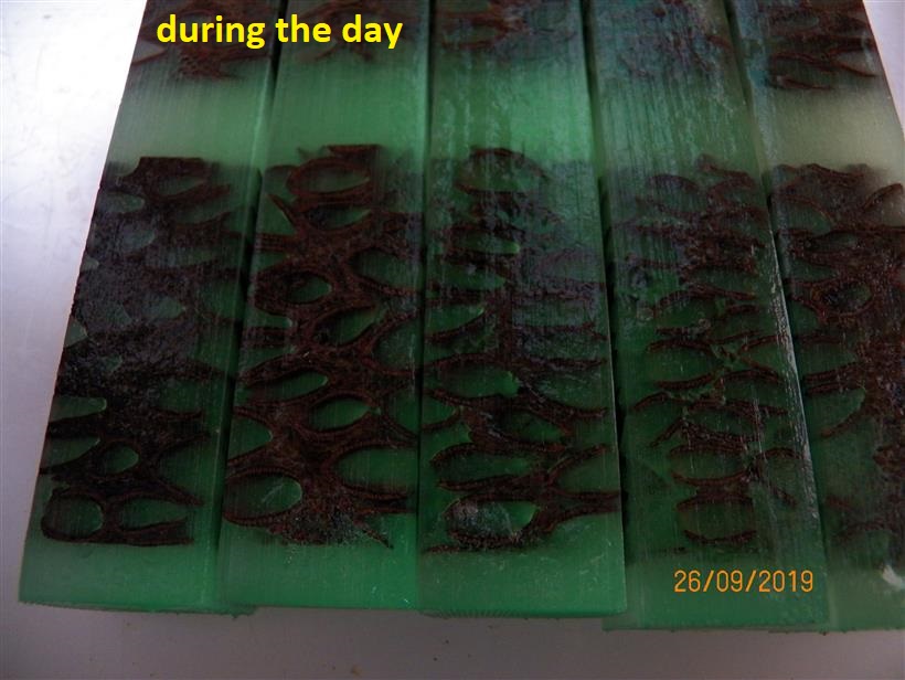

Hi folks,
I had a request to make some Resifill blanks using the Dwarf Banksia pods and green glow powder, the person making this request is from the UK and he developed an idea based on the information he got from the people that make this new product,
with a claim to be the strongest glow in the world I had to see for myself so I order a 50gr container and proceeded to cast 5 blanks with epoxy resin and this new glow powder. I know that for a stronger effect the more powder you use the better so I used about 20gr of powder on 0.5 litre resin and mixed away.
I can say that the strongest results are obtained following their instructions on the painting style application where a special base is used prior to the glow but for mixing with resin, the best results will be achieved with solid/100% resin casts as embedding objects into it will interrupt the glow distribution and therefore reducing the glow strength and glow time, this is an obvious result.
From my experience with different types of glow in the dark products, I'm certain that this new powder offers a slightly stronger glow something about the 25% extra so, I thought in making my observations of this product among our caster friends and let them have a go and try it.
Here are some of the pics I took from the 5 blanks I made.
Cheers
George

THAT sure looks very interesting! Thanks for posting.
I am guessing that the reason you didn't mix and a higher rate is because of the cost, or would it be that - any more density would diminish the strength of the resin?

Your question is most valid and pertinent, and the answer is, a combination of both, $16.72GBP for 50gr represents AU$30.44 or USD$20.62 so yes cost has to be considered but in regards to the density of powder VS resin, even though each resin/any liquid has its own saturation point I don't know unless I do lots of testing to find that saturation point on the Epoxy resin I'm using, evidently, there will be a point where the strength of the resin will be compromised by too much powder.
I was happy to use a max. of 25gr. in the 0.5 lt resin even though I only used about 20% as I had a gut feeling that I was getting too close to saturation but, I can be wrong and like I said, only testing will answer that question with a high level of accuracy.
Hope this helps.
Cheers
George

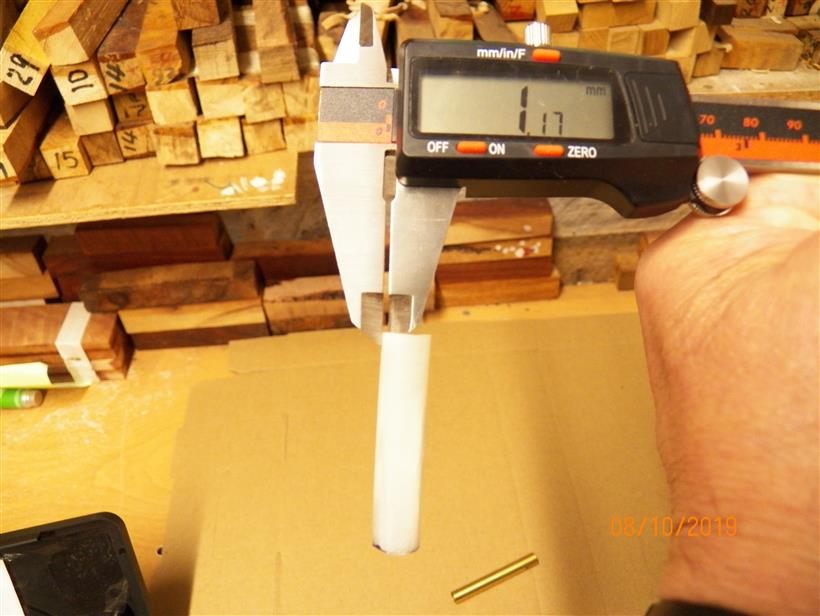

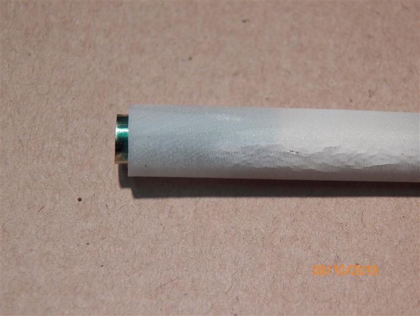

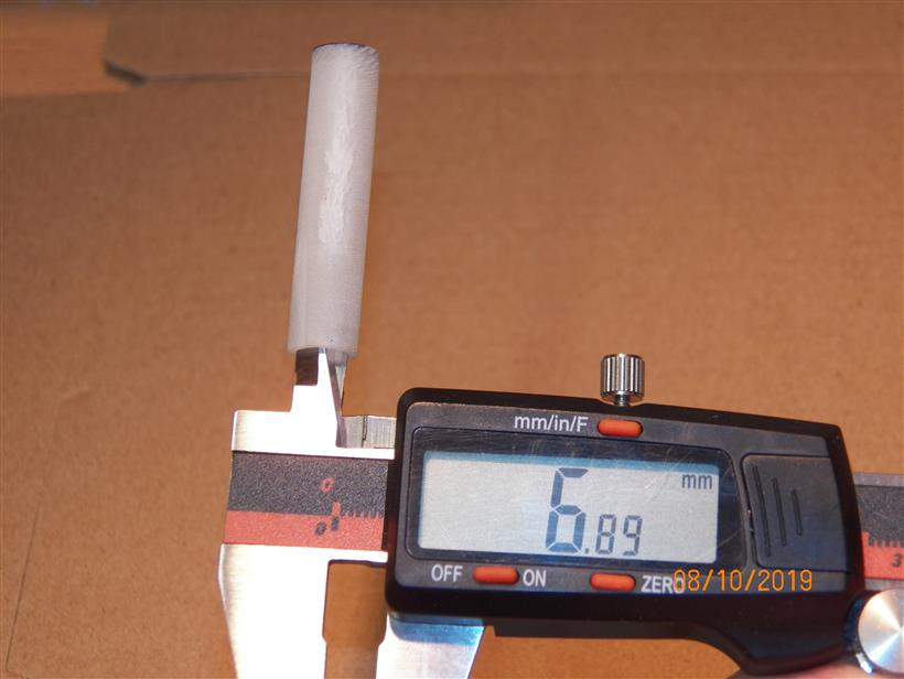

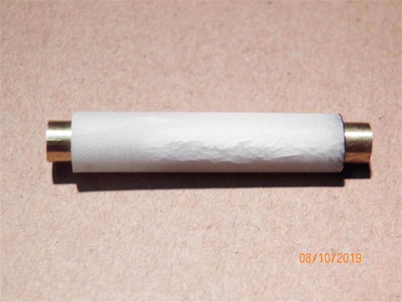

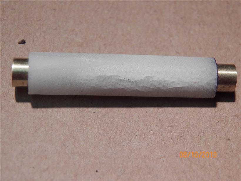

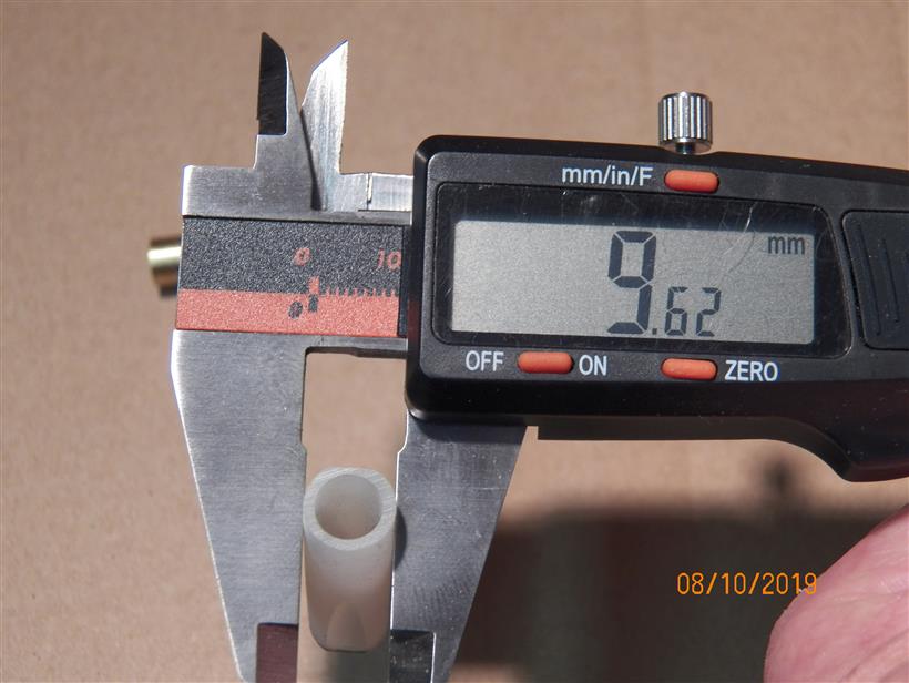

Tony,

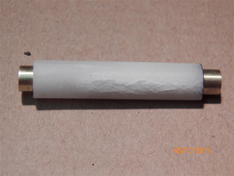

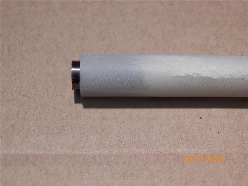

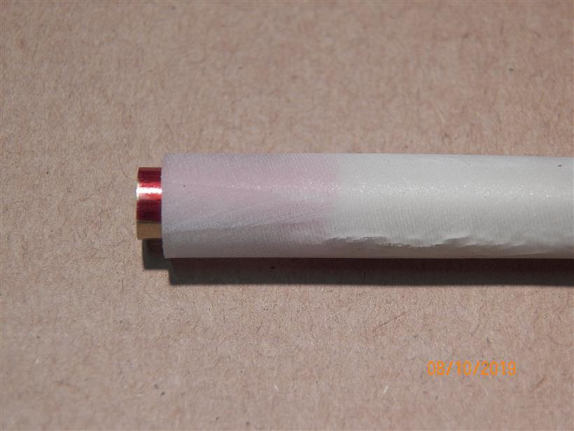

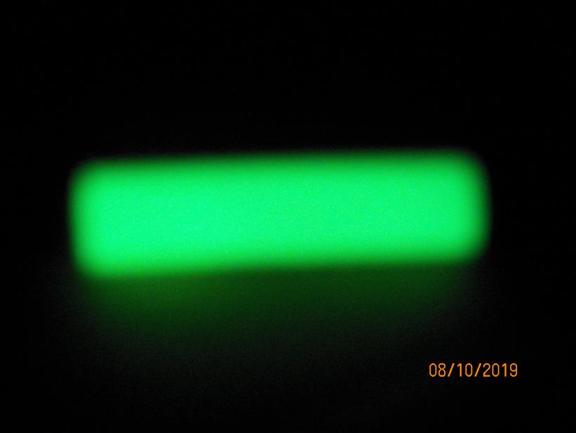

I have done exactly what I said I was going to do, the round flat sample endup only being 10mm thick so I cut a small slice to make it sure not long enough to cover the full tube but was enough for this test
I didn't take much attention on drilling the 10mm square piece of acrylic on my drill press so the whole was not totally centred but again, that didn't stop me from continuing on.
What you see is the barrel/acrylic surface out of my lathe no sanding, I never had that much material to work with so I got it almost all round, some spots the tool barely touched the resin, I could take a little more (less than 1mm) but then it would be too thin for sure.
In the pics, you see the thickness left in that barrel and the overall barrel diameter, I decided to try colouring (marker) a portion of the tube and compare it against the tube brass colour and see what different "shades" I would get and the results are as predicted and mentioned on my previous post.
As for the glow strength well, considering that the tube is hollow what is left did still produce some good glow but it didn't last long, obviously.
I wonder if you would get better results by painting the tube with the base and paint they have and shown in their video and then cast it in clear resin, I'm sure the results would very different and from what I saw from the glow strength during the day on the paper they painted a few strips I wouldn't be surprised if the results would be surprisingly good but I don't have those materials nor I want to get into that but as an idea, maybe some of you want to try it out.
Cheers
George

Tony,
Cheers
George
That looks pretty darn good!
I forgot to say that the glow shot still had the brass tube inside, I had it next to a strong light for 20 seconds or so.
I've done it for my own curiosity and bo be able to have some answers for you and probably many others that are following this issue, I'm in no hurry to make glow blanks unless a specific order is made so, I hope this will help someone.
