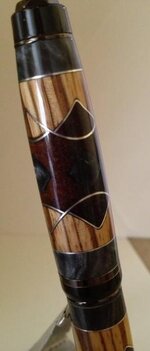

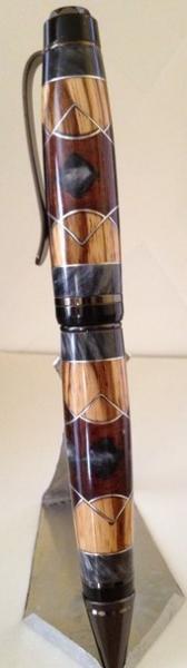

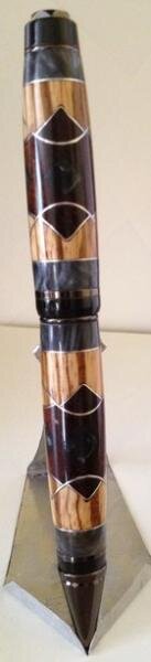

Finally finished! It's not exactly perfect but for my first "real" segmenting I think I did well.
I think you also did quite well. I wish the photos were better or more of them to really show off the work. Now do not stop here. Take it to the next level or at least do a different combination. I like your thinking. Keep it up and thanks for showing.

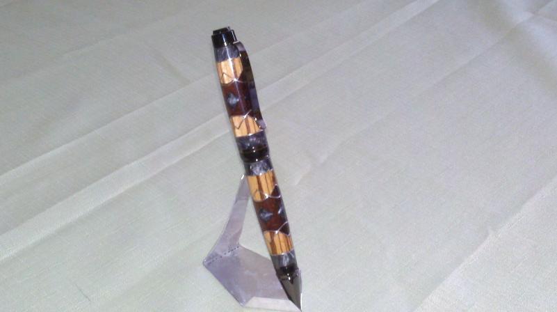

Thanks for the comments, I'm working on getting better pics. I took these with my phone and it's not the greatest at taking pics. The wife is playing around with her camera right now as I type so we'll see what comes of it!
