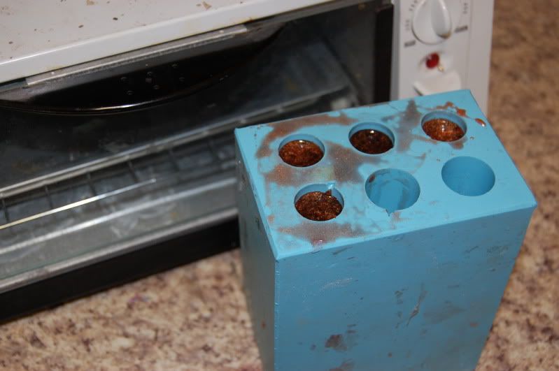

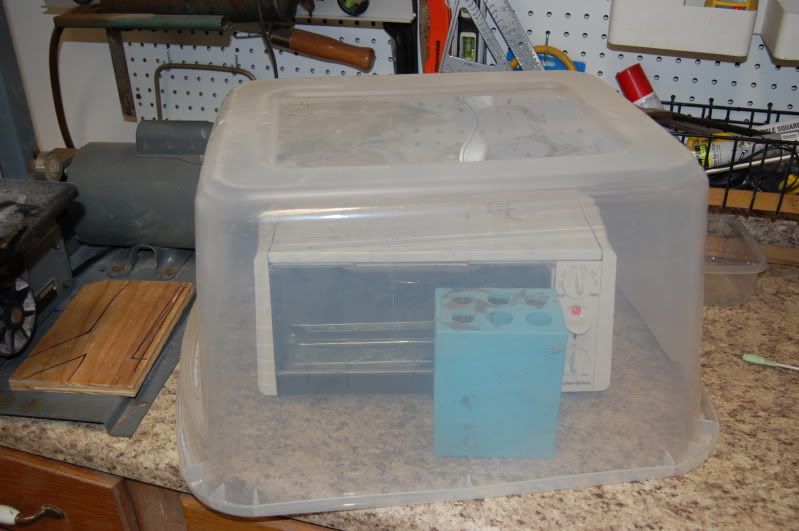

It is jt an idea. I bought a toaster oven to stick blanks in and get the tacky feel off the outside of them after removing from my mold. I have since figured out that I can cut my cure time down significantly by taking a plastic tub and Turning it upside down over the top of the oven and mold. I do not put the mold in the oven. I just use it for the heat. I can take a pic in a bit and post it later tonight. I leave the corner of the tub open over the counter for degas and air flow. If I has it to do again I think I would opt for the crock pot as I think I regulate temp better

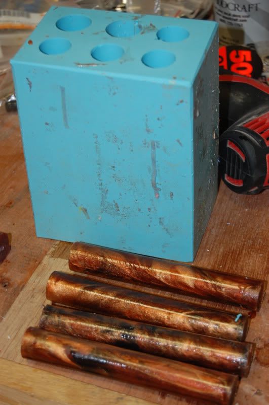

here is how I do mine out in the shop. If needed I could run an extension cord outside and do it on the porch. and a pic of the blanks that were in the mold for the pic.
That's almost the same way I cure, except I put a hair dryer in the box. I've been talking to Dad about putting the mold on a heating pad and seeing what it does.

I always stay with mine as I don't pour when I have other things to do. I just use this to accerate the curing time. I would think the crock pot would be somewhat safer. As no exposed elements.
