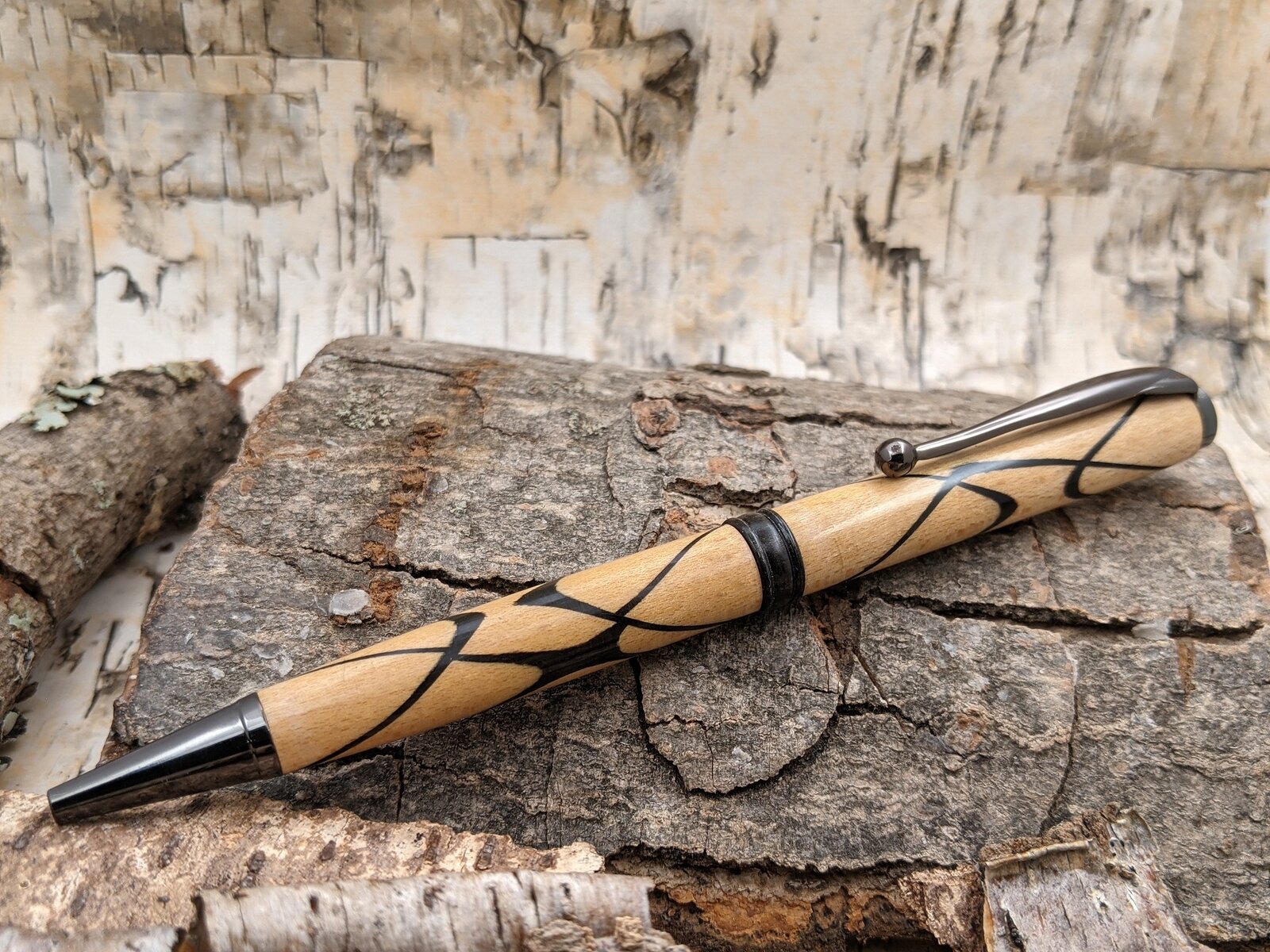

I think it depends entirely on the segmenting. I'd be reluctant to try something as thick as 1/16" in an application where it had to bend a lot, like one of these:
...but it's perfectly fine (and some would say better than the thin stuff) for straight/angled segments like celtic knots. Using a piece of the thick veneer bracketed by pieces of thinner modern veneer in a contrasting wood could also work well.

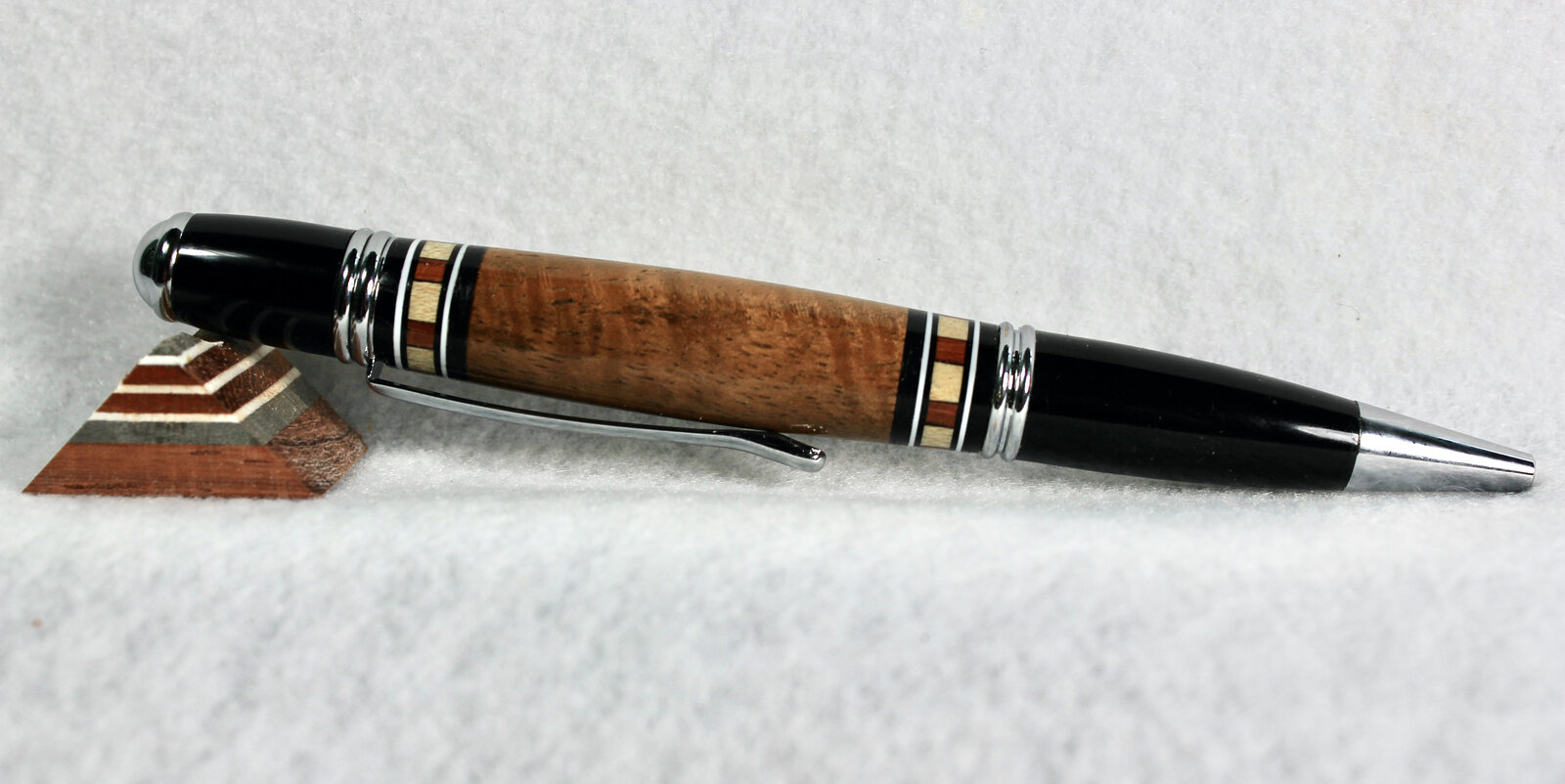

In the photo below, the 4 white rings are 1/32".
