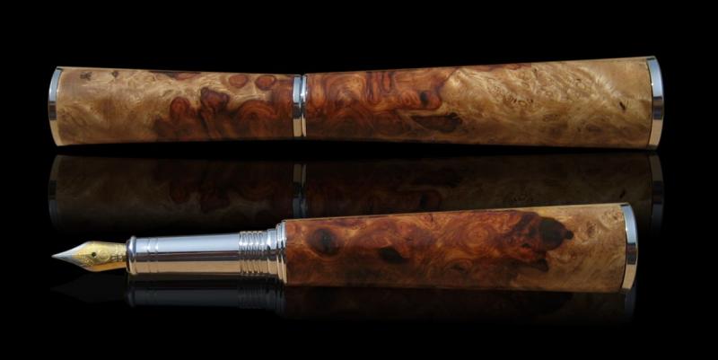

Hi all,
If you know the name or can point me to where I can buy the Fountain Pen you'll see on the attached picture, I will be forever grateful. Also, can you recommend a few good sources to buy pen kits from.
Best regards
Pedro
Pedro -- You need the nib feed assembly and lower section from the Junior Statesman --
You can purchase some replacement feed assemblies -- but may need a tap to chase threads when changing feed assemblies that are close in size -- and there are several sizes that are not interchangable. Most component pens come with one of 2 or three sizes. I have not converted Panache to fountain pens and do not have those sizes handy.
the metal nibs can be generally interchanged by removal from the nib assembly and replacement with a similar sized nib. Commonly these upgrades take a bit of futzing to get just right. There are several vendors who sell upgrade nibs.
To be clear, depending on which plating you got the Panache in, you'll need the matching plating in a Jr. Gent II Fountain. The Jr. Statesman swap will only work if the plating on the Panache is Rhodium.
