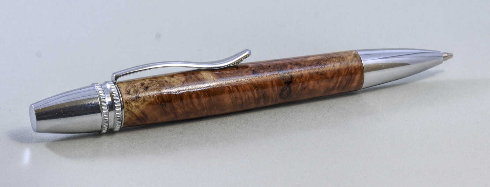

Not sure if these are available over there, but the Polaris timber section is 2.8". Maybe the photo will help to see if this style is available (probably under a different name).
Cheers, Gary
Gary, the Polaris is indeed available in this part of the world. . It sometimes gets called Carbara. . And possibly another name also (Atlas ?).
