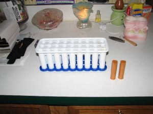

Just bought an ice tray that make ice for coke bottles at Walmart. Poured PR in 2 of the section and made perfect blanks. The tray has 27 molds and you can get a blank that is 3-3/8" long X 3/4" wide. Gotta figure out how to mix colors next.
Has anyone else tried this mold?.......

looks kinda short? How tall are the finished blanks? Looks like it would be good for the single barrel kits, or with solid colors, but there is nothing to line up from one section to the next.

They are 3-3/8" long....from experience when mixing multi-color blanks and blowing a few, it's not hard to match them up from one area to the other if you pour more than one. One color blanks is a no-brainer. Anyhow, tomorrow will be the test for me.

George, Might be something like that could happen, the things are rather bulky in size, they are about 10 inches 250mm by 4 inches 100mm in and 3-1/2 inches and 89 mm in size and weigh right at 260 grams each, I believe they are under 5.00 each. I have a brand new one sitting on a shelf, I bought it about a year ago and just haven't used it, and don't remember exactly what it cost, I know it wasn't much. is it as hard to send things to OZ as it is to Great Britain?
