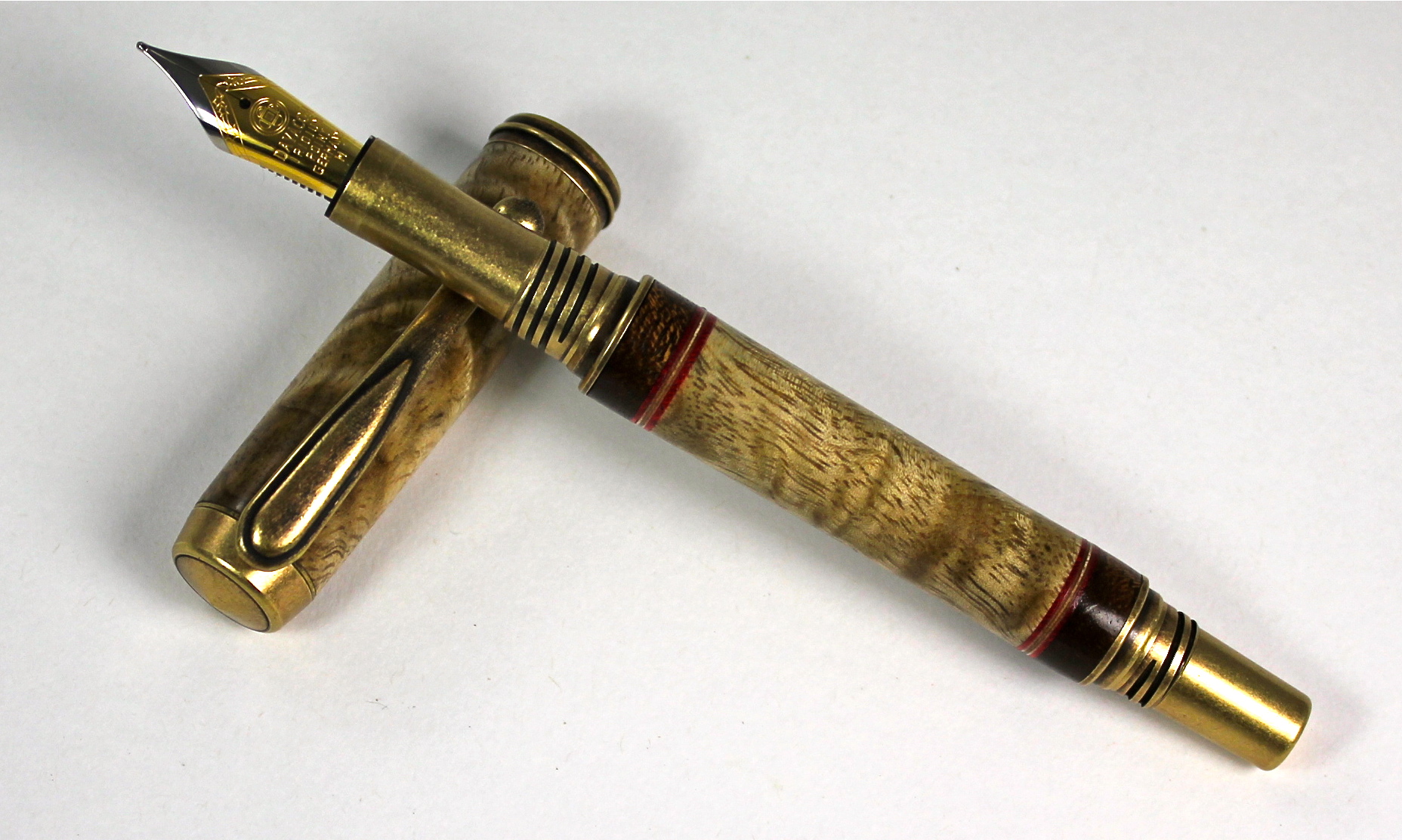

JT knows exactly what I am thinking, you just post a picture of one of your segmented pens that was done on 4 sides .

If you are talking about a scalloped pen, I could have done that on a 6 sided or even an 8 sided pen if I wanted to. All depends how many facets I cut the blank in. But you lose the arc in the scallop.
Loosing the arc
