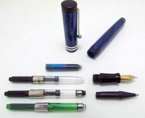

I recently purchased a Canon Power Shot XS30 IS and the more I use it the more frustrated I become with it.
Now I realize it's no where close to a really nice camera but is also is far from being one of the cheapest and I would expect it would take some nicer photos in the "automatic" mode.
I made a light tent using flourescent "bright white" or "bright effects" bulbs and the tent is brilliantly bright inside but when I take some shots without flash I get a muddled blue tint.
I am guessing this might have to do with some settings but I can't find anything.
I just posted some shots in my photo album, one is here.... http://www.penturners.org/photos/index.php?n=19272
Any ideas or suggestions?

This looks like a white balance issue.
More information please. What is the Kelvin or K temperature of the lights that you are using? What balance setting is the camera using?
I had a similar issue not long ago. Even though I was using daylight balanced bulbs, I had to change the camera setting to florescent to get acceptable result.
If I remember correctly "brilliant white" bulbs are about 3400 degrees K, which would definitely require take the camera off automatic and setting the light source setting to florescent ( the one that looks like a caterpillar).

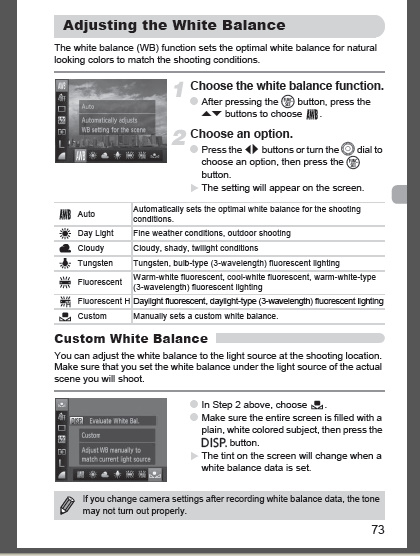

look on page 73 of your camera manuel it tells you how to change your white balance to match the light source.

George, do you have an White Balance setting? On some Canons there is a auto white balance setting. Thats the first thing I would look at. The lights your using "Bright Effects are what I use, If you don't have a W/B auto setting you will have a W/B setting using a grey card to set your W/B. your local photo shop will have one for around $10 or you can use a grey paper.

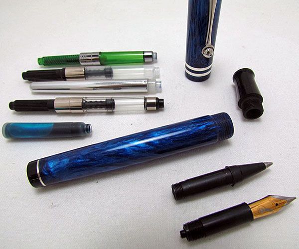

I'm sure the guys above have it. I am no expert, but am playing with Adobe Lightroom. Here's the result of 2 minutes of playing.

Is this more like what you're after?
If so, the first thing you need is more light. The photo is underexposed and lacks dynamic range (which is a common problem with using a light tent). Next, you'll need to find out how to set your camera's white balance.

+ 1 (or whatever the number is up to now) on using a gray card and setting a Custom White Balance.
I don't know if it's neccessary but I always set all my controls first ... Macro, flash on or off, timer,etc, THEN perform the Custom White Balance operation by filling the viewfinder with the gray card under the existing lighting and pressing the button to save the setting.

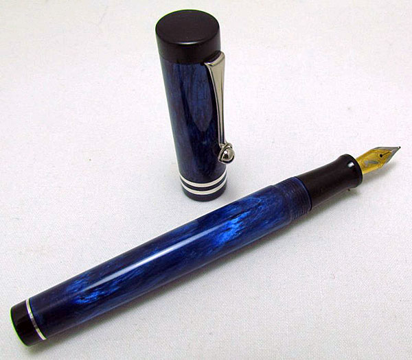

First....... THANKS for all the helpful replies you guys are great! Once I knew what to look for "White Balance", I went back through the manual.
I had stopped on page 73 where I set the macro function but had I gone just four pages more I would have found the answer, on page 77 it discusses setting white balance and I started playing with "flourescent" and "flourescent H". I took another few shots and they are decidely better! http://www.penturners.org/photos/index.php?n=19275
I think now might be a good time to add the other side lamps to the light tent to see if the shadows go away.

George, all I have to say is NICE PEN!!! Looks like you've got the lighting figured out, so have a compliment instead...
Of course it's a nice pen...... I made it! :biggrin:
Seriously, thanks for the compliment, that's one of my daily users I made a few months ago, these photos are more about the section and how it's drilled and threaded to allow several different nibs to be used. I was hoping to learn the macro shooting well enough since several folks have asked for some in-depth explaination on how the insides of the sections are done and I am a firm believer that a picture is worth a thousand words!
I bought this camera with the hopes of taking some very tight shots of things like the insides of a feed housing or section but I don't think I'll get there with this camera because in the macro mode I can't zoom in else everything goes out of focus.

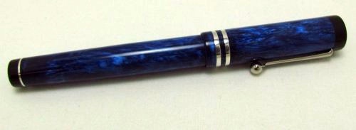

George,
That's a lot better. The exposure is good and so is the white balance. It's still a bit shy in dynamic range and quite soft. I suspect your editing program isn't doing a good job in resizing the photo. It also stripped off the EXIF data so I can't see what your camera settings were and produced an unnecessarily large file. A quick photoshop tweak gave me this:
Some other suggestions are:
  • Move back a little. There's quite a bit of foreshortening in your photos. If you shoot from farther away and use the zoom to fill the frame, you'll get less distortion. Be sure not to engage any "digital zoom", however. That's just the camera resampling the image internally - something you can do better in post-processing. Use the optical zoom only.
  • Shoot from a tripod (which I presume you're doing already) and turn image stabilization OFF. IS can actually "hunt" for vibration and introduce blur when tripod mounted. Use a time-delay or remote activated shutter release.
  • Try a lower (more from the front than from above) camera angle. Don't be afraid to experiment! Move your lights around to control the shadows. The only cost is time.
