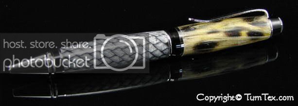

Yep, here is the gar I did. It is actually not just the skin. It is the skin with the scales. All I did was skin the gar and then scrape off all the meat on the back side. I then pinned it to a board and liberally applied Borax and let it all dry. I use Borax for turkey tail mounts and many other things and it works great.

YEP. I use it all the time for preserving things. I have a number of turkey tail fans that I did and some of them are many years old. They are all still perfect. Borax is not good for skins that you need to be nice and soft such as for belts and such but for a pen where it will be encased in resin it is perfect.
