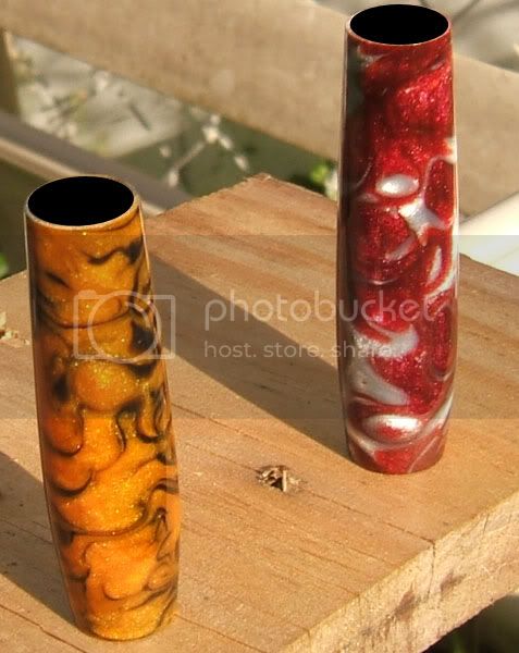

These are the two I was working on. The orange/black is the one that had the mishap. I didn't even finish polishing it.

It was only my 2nd attempt at buffing a pen on my new dedicated buffer. The first one I did with the rotation of the wheel, no problems.
The 2nd one, I tried against the rotation of the wheel and bam!!:eek: It went so fast, I did not even see what direction it went. But I did hear it and new instantly it was ruined. Stupid of me to use a pen I had a lot of hours in.
It was a reproduction of Barry Gross' copyrighted beer cap pen.
Both were held free hand.
