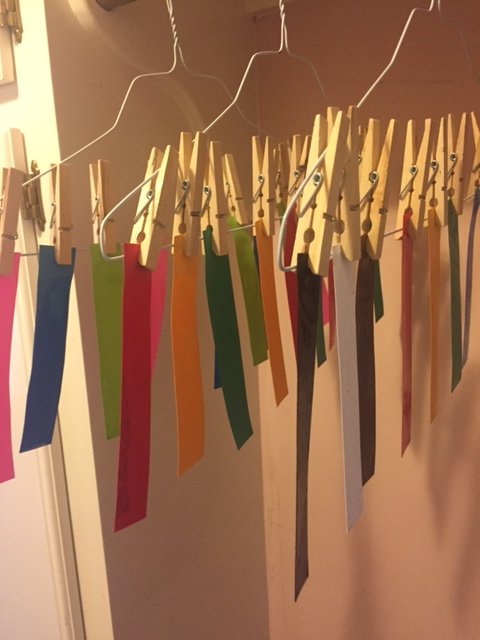

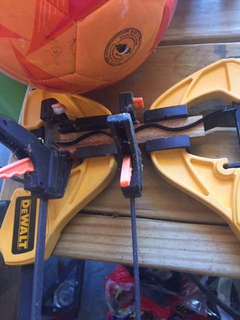

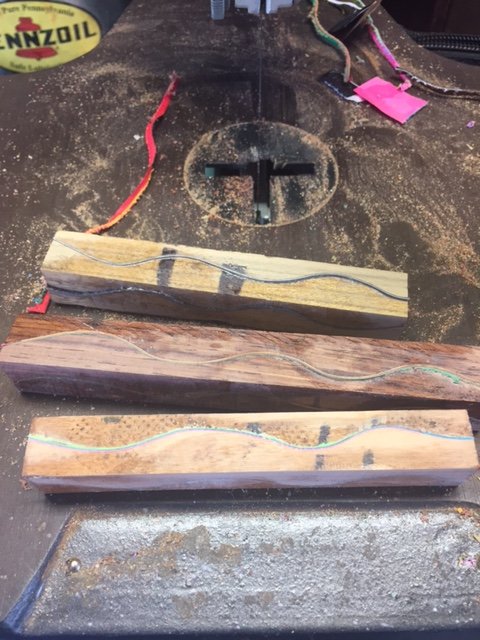

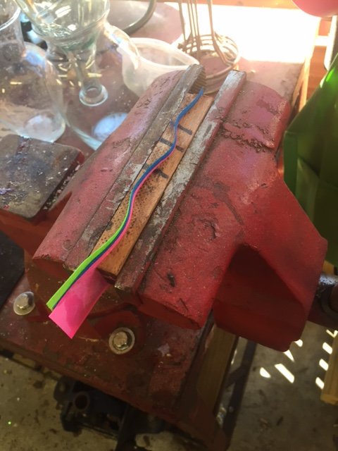

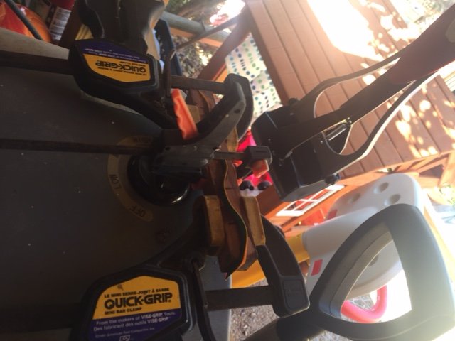

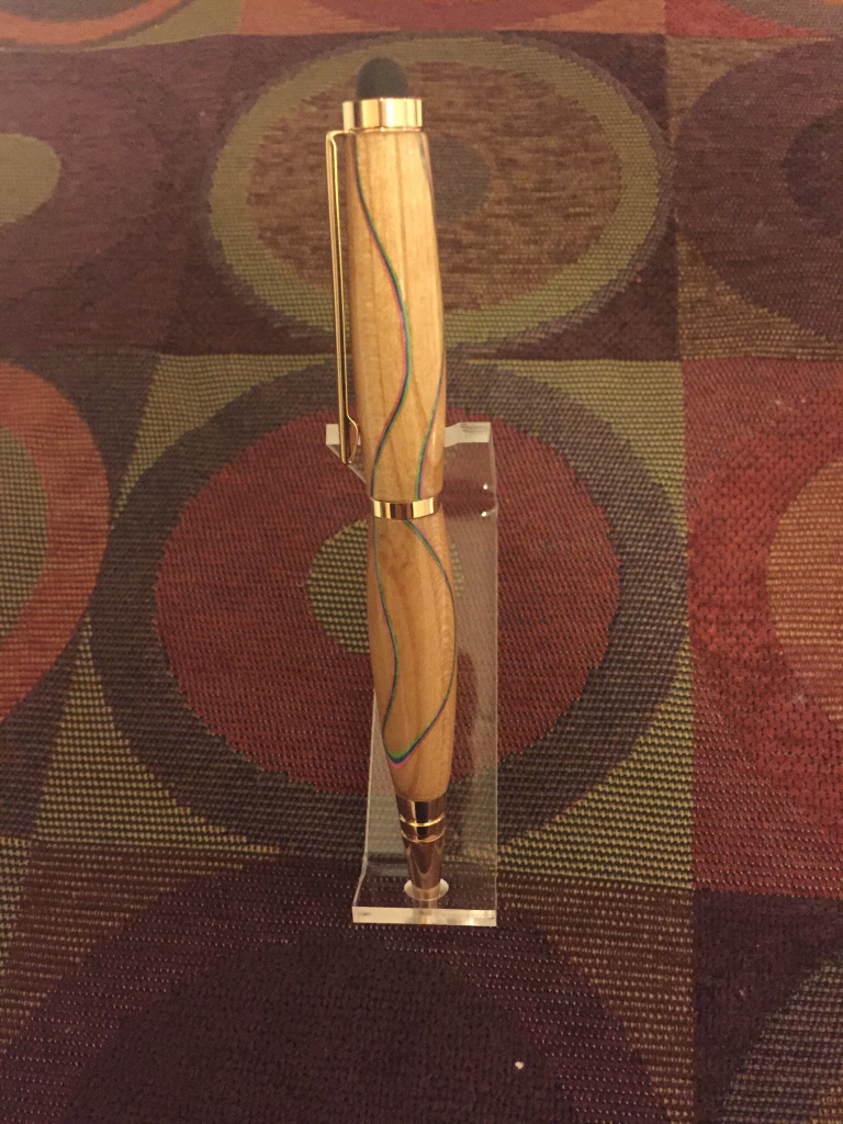

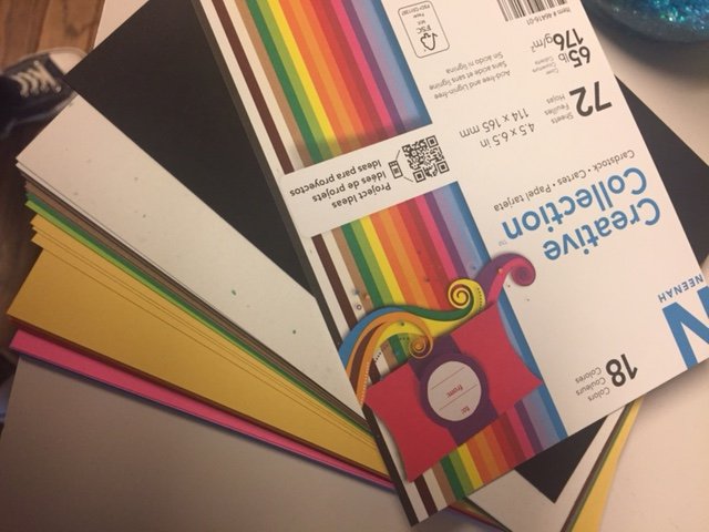

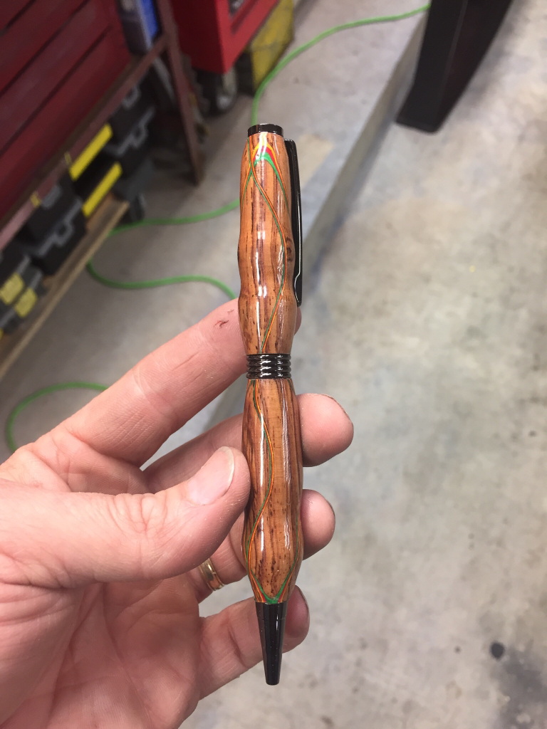

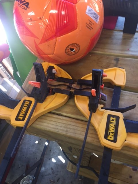

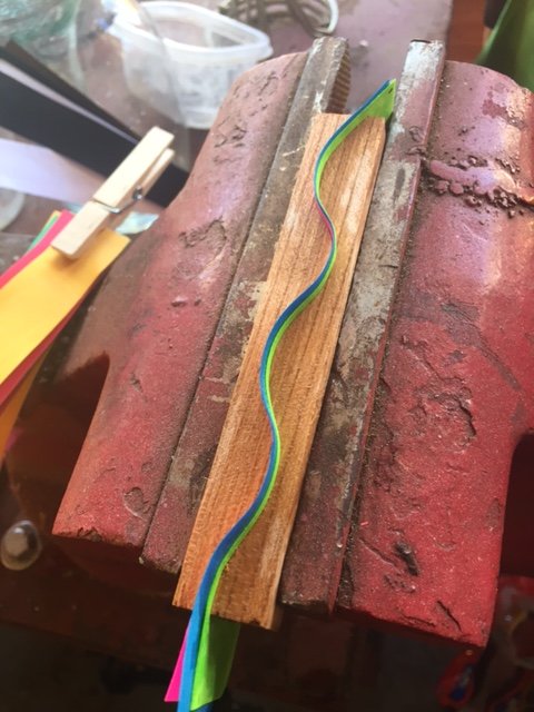

Well when you work nights in front of a computer you tend to do a lot of YouTube watching to pass time. Watched a video of taking construction paper to glue up into blocks to add colored lines to the blanks. I told my wife about it and you guessed it I am trying it. So far on the progress:
I'm guessing you've been watching RJBWoodturner's videos. It looks like the blanks have turned out good, let us know how it goes.
Yep I love his videos. For a newbie like me he makes them super understandable. I also love how he will show failures and fixes. I am itching to try his color pencil idea.
