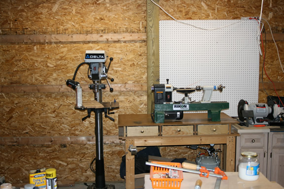

The attached picture is the coming together of my new shop. I just included a pic of the drill press and lathe stand area. Basically, the issue that I have is what's in the background. I have a pole building and as you can see, there are large 6 x 6 posts and then 2x4's that span the rest of the way. OSB is attached to the 2x4s from the outside and siding.
I want to be able to add cabinets, shelves and misc. storage. I was thinking about filling the gaps btwn the 2x4's with some of the foam insulation board and then covering it with OSB or drywall. What do you guys think about that? The insulation is most important...Being in Ohio and I want to be able to contain the heat once I start generating some in the winter.
The other option is NOT covering up the insulation(saves big money) and just attach some vertical bracing to help support the add on storage.
I am struggling with this...Any ideas or opinions would be greatly appreciated.

If this is a shop that is enclosed year round with no venting then I would insulate. I would check on the use of that foam board. Some areas won't allow that as insulation. Fire rating or something. Why not fiberglass batting.
Well the space available is only the thickness of the 2x4 so I dont know how well they will work since they are nominally 3.5 inches thick...That is why I was thinking about sheets of insulation...I will just have to check on fire code.
Grub32
When I started my shop construction I pondered the same thing you are. For some reason or another - maybe I was holding my mouth just right or something - I decided to use 2" closed cell styrofoam for insulation. I made myself a hot wire cutter and custom cut all the panels from roofing panels that I could get from a local supplier.
BOY AM I GLAD I DID. It has made all the difference you could possibly imagine. I even put the panels in the ceiling. I also added a sheet of Tyvek house wrap on the inside of the ceiling rafters and now there is way less heat loss. I use a kerosene heater like you would find at a job site - burns like a jet engine - and the danged thing will run me out if I don't turn it off in short order.
Maybe if you just insulated between the wall 2x4's and used either house wrap or a sheeting of good quality plastic you could obtain the same results and be warm as a bug in a rug in the winter. It is also cooler in the summer as heat doesn't infiltrate from the roof quite as easy. Best of luck on your decision(s). :biggrin:
Check out spay foaming.........total coverage and it will also act as a vapor barrier.....no cold air sneaking in or hot leaking through during the winter. (not talking about the canned stuff either.....)
Barney
I agree with Barney, be sure to check out the spray foam. It almost totally insures there will be no holes or gaps allowing air infiltration! Also, I would seriously consider putting either OSB, plywood, or even drywall over the insulation. You want to make sure you can paint the inside white or near white to help with your lighting. Some shops that are left unpainted or are dark colored, require added light sources to get to a decent level to avoid eye strain.
Also, if you just added backer boards where you are proposing to hang stuff now, you will be adding more and more later as you change and redesign or acquire more stuff or more patterns and things. If you must rearrange your backer boards each time, or add more, the cost will sonn be more than what the OSB would have cost to start with.
You might want to think about using french cleats to hang a lot of your stuff. This will give you flexibility to change things around a lot easier.
Thats just my opinion.
By the way, my shop is converted welding shop that had a tin exterior on angle iron pearlings with 3" pipe columns and angle iron trusses. I have installed 2x4, insulation, and covered with plywood, painted everything white, used french cleats to hang my cabinets and displays on, and couldn't be happier.

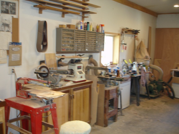

Here's some shop photo's. Built my shop all myself, although I contracted out the structural installation of the poles and roof..that's a bit much for one man to do. Look carefully and you'll see how the ports go right in the wall. There are no pipes looking ugly in the shop, taking up un-necessary space and collecting more dust.
