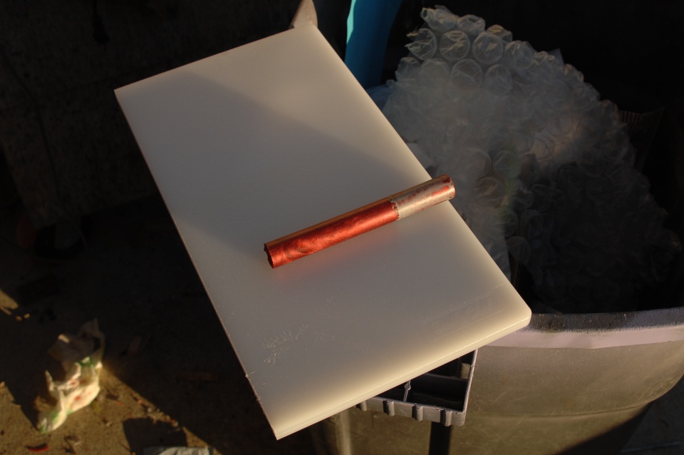

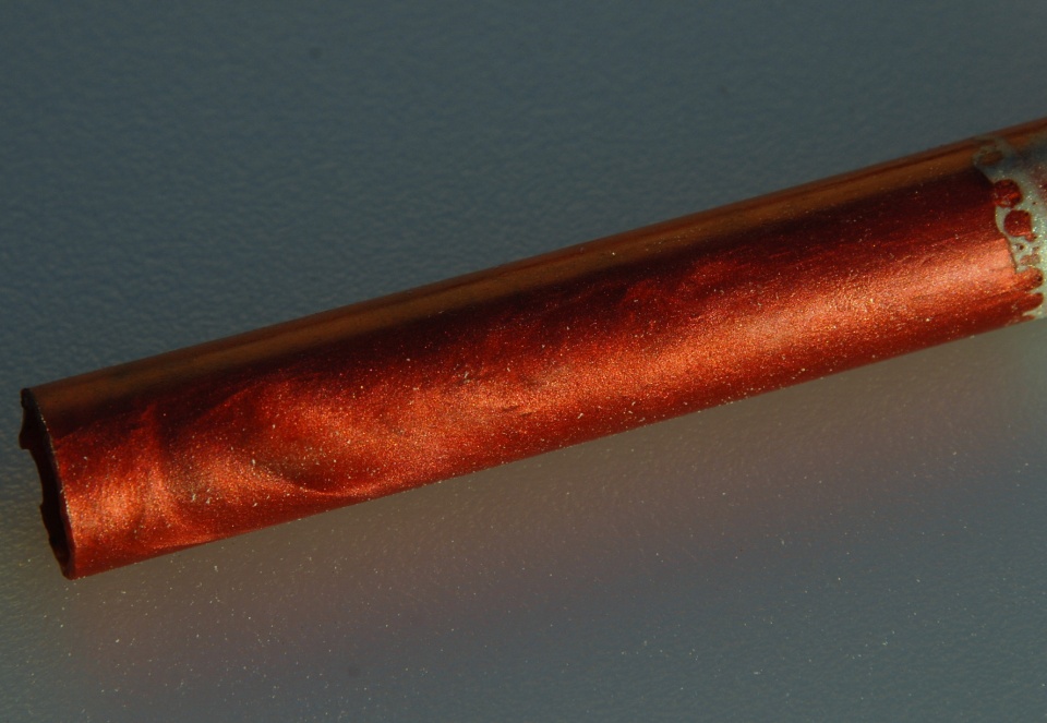

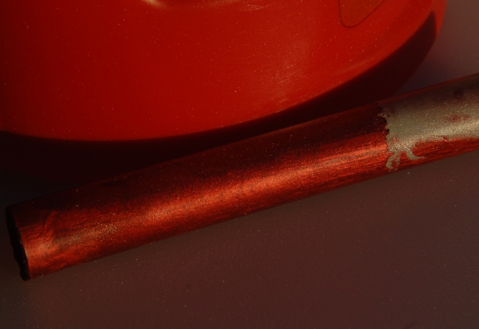

Here are 3 quick shots in the afternoon sun. the red container is a Folgers Coffee container for comparison.
attachment.php
attachment.php
attachment.php
That is the maroon/burgundy side of the red micas. Still not a true red.
