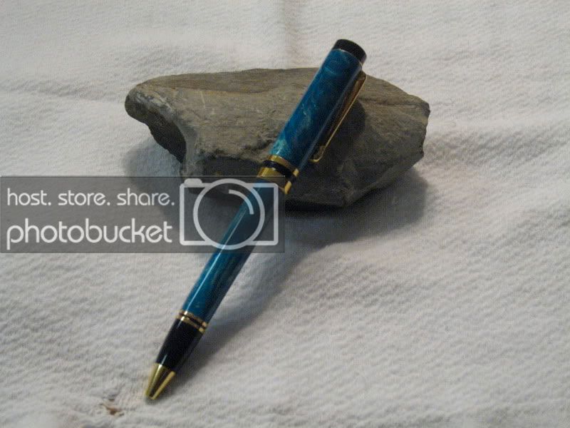

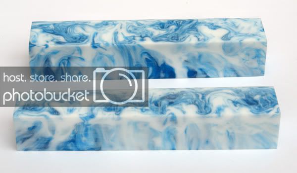

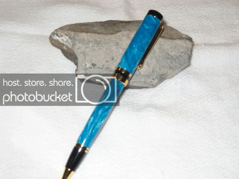

Hi Chris I cast a lot of PR about 25 ltr's every 3 to 4 weeks, I never have to pressurize unless I have the ribbon effect, my home-made mold will take 2.9 ltr at a time, I use a pigment paste and pearl-ex powder with the pearl-ex only being 30% of 2.9 ltr the rest is the base colour i.e. white, blue is the pearl-ex and flamingo pink is the pearl-ex powder.
I use the big kitchen measuring plastic jugs, these can be used time and time again, now the way I mix my colours are done with two jugs, one say white and the other say blue pearl-ex I also add the right amount of hardener to each jug about 1 in 10 a little less for the summertime.
The hardener and the colours are mixed at the same time with my drill and a wooden spoon but are poured slowly and at random layers until my mold is full, some vibration will be needed but I think the secret is, is to pour slow and that's it! I don't touch, leave it and let it do its own thing.
Hope I have explained this ok and have help in some sort of way.
Mervyn
www.ukpenkits.com

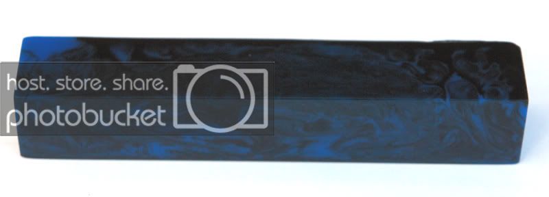

Yes you have explained it well. Those are some nice blanks I hope to get that good to make some of my own. I have been trying to make a black and gold pen blank. That is the colors of the New Orleans Saints. But I am having problems with the colors. I am using paint and the black gels a lot faster then the gold. Now that I have the bubble thing fixed I need to work on the colors.

Hi Chris, are you using paint or a pigment paste and what sort of effect are you after?
If say you have a mold that will take 600ml of resin use 200ml of gold pearl-ex and 400ml of black paste mix it separately in two jugs with 2ml of hardener in the pearl-ex jug and 3ml of hardener in the black jug.
pour some of the black in the base of the mold, not much just so that it covers the base and then pour a little of the gold in a figure 8, then the black in a figure 8 until the mold is full and you have used your mixes, pour these reasonably slow like your drawing lines in the mold, don't mix at all, leave it to take its cause, the chemical reaction will do the rest.
If you have the right stuff like I use you should have an effect like my blanks, any problems drop me a line.
