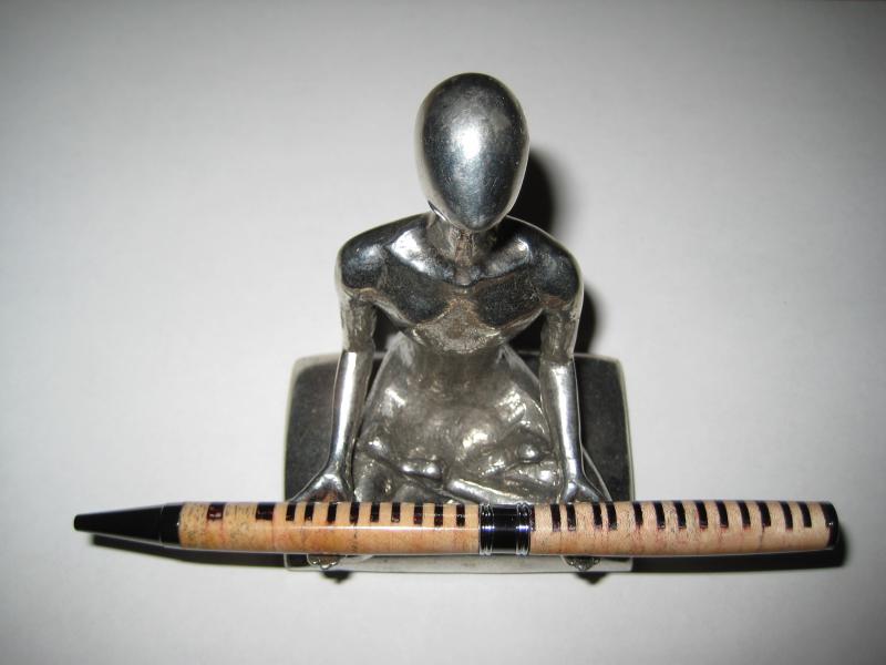

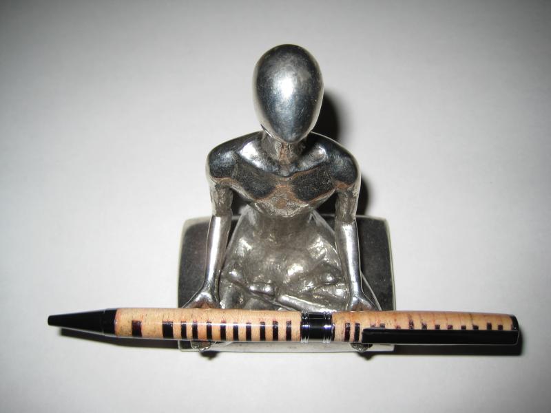

I've been trying forever to perfect my CA finish. The first few times I did one, it came out great, and while things like that should improve over time, it seemed like my CA finishing skills were rapidly declining. I've gotten input from several people about how they do theirs and have watched some great turners demontrate their technique. Well finally, I was watching the youtube video that someone posted about the grub32 finish and I had an epiphany while watching it.
I noticed something, probably something everyone else did that I just never noticed, but I realized that he seemed to be using a paper towel to spread the CA. I was using foamy stuff to spread the CA- so as to avoid it sticking- and so was ending up with major ridges on the barrels, and then when I'd go to try to sand those out, I'd end up sanding away my CA finish.
So today I tried spreading the CA with a viva paper towel instead, and wiping it across well so that the surface ended up pretty flat. Amazingly, it seemed to work! Now I've only done one pen finish so far with this new found insight, but hopefully other ones that I try to finish with CA now will come out better. I kept wondering, how are people getting rid of these nasty ridges after they apply the CA, but now I think hhmmm... maybe they never created them in the first place!
Since I was reminded of the rule of thumb around here that "no pictures, didn't happen" I decided to add some pictures of this pen with the CA finish. (I actually quoted that saying to a friend the other day when he forgot to take pix after visiting somewhere that I've been dying to go and I told him he couldn't log the cache since he didn't get pix, and I used this site as a reference for that steadfast rule!) :biggrin:
(And BTW, credit for the great pen blank goes to wood-of-1kind!)

Angela, #1 rule for a sweet CA finish: use a hard sanding block behind your sandpaper for early sanding. The hard block will make it so you hit just the ridges and the sandpaper can't get down into the valleys to punch through the finish.
Great looking pen!!
