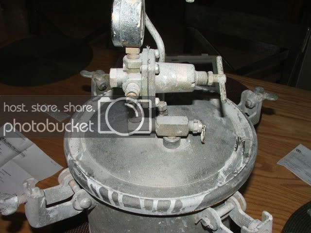

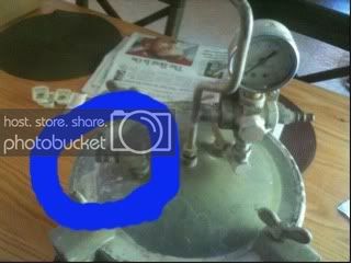

do i have my pot set up rite? also what do i do about the fitting in the blue circle
The picture is too small for me to see too acurately what I am looking at. If that fitting where the blue is, is an open hole that air can go through, you need to pull that fitting out and install a plug. I do not see a safety pressure release valve on that pot...I can't force you to use it, but I can't recommend that you don't have one. I also do not see a ball valve..although it might still be there but hidden. Should have a ball valve between the guage and the quick disconnect. You hook up the hose to the quick connect, then turn on the valve to fill the pot, then when full you turn off the valve and un hook the hose. To remove the air from the pot, you then turn the valve back to on and you can control the speed of which the air leaves as well using the valve.
Inside the lid, directly under the guage, that is where the air goes in to the pot. You should have a 90 degree elbow or a T installed to divert air to the walls of the pot as it enters rather than having it blow direct down on to your resin.
On the bottom inside the pot you should cut a round piece of plywood and insert it down there because most pots are concave in the bottom and the wood will give you a flat place for your mold to sit. Covering the plywood with wax paper is a good idea because if you drip some resin over the mold to the wood, it could stick your wood and mold together.
Here are some more picures

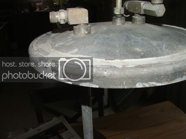

Over all picture of the lid

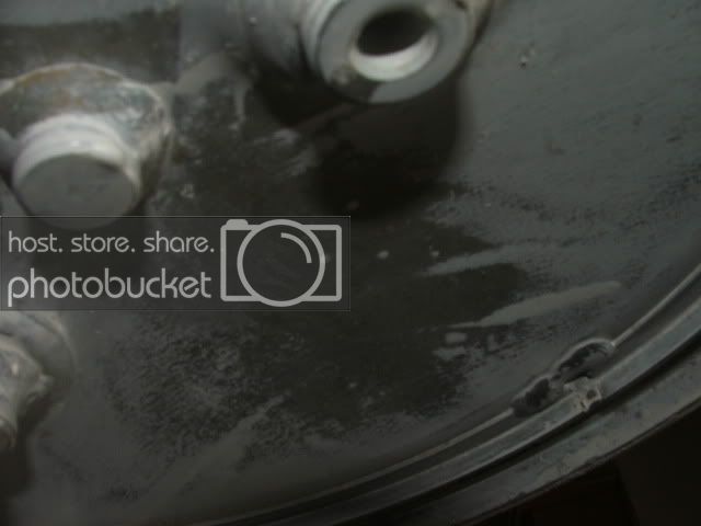

this picture shows the fitting in question. so i need to remove both parts and install a cap (can i get that at Home Depot or are there special caps for pressure pots?
This the the inlet under the pressure gauge, how would you clean the threads so that a T or elbow can be installed?

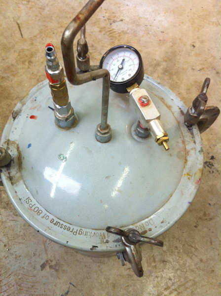

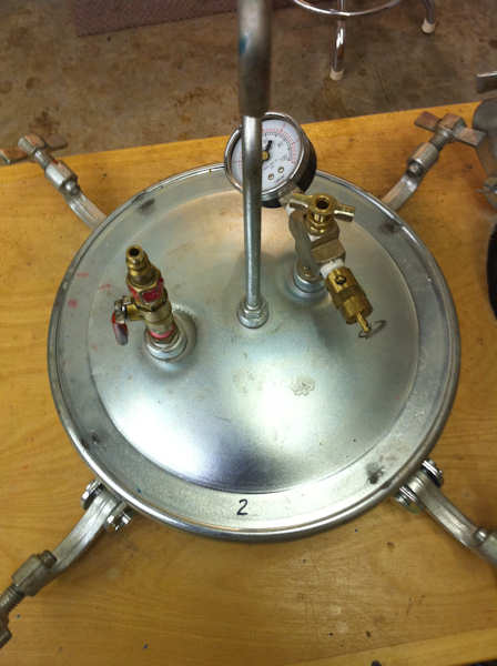

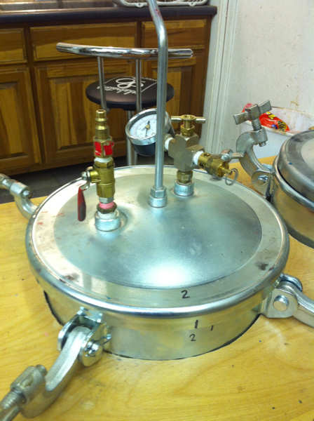

Ditch the regulator completely. You will be regulating the amount of pressure yourself with the ball valve. Leaving the regulator on the pot just adds weight to the lid and more potential for leaks. Here is a picture of one of my pots for reference. I have also included one of my old HF pots that has a similar pressure relief valve to give you some ideas.

Yep...like Curtis' pot is real good. The plug will be available at any hardware store, as will all the parts you need, although if you don't have a safety relief valve then I don't know where you get that. My pot has a different type of safety valve and it goes in that second hole instead of a plug. It is a vertical safety valve and much smaller and better than the HF style in my opinion because it doesn't have that flimsy ball nut connection on the bottom of it where if you tighten it up too much you break the ball or nut in half. I always had issues with that HF style relief valve leaking air on me. As you can see by the way Curtis set his up too, the weak point on that valve is less of an issue because he is also using it in the second hole instead of a plug and filling the air in hole #1 so that the human pressure of putting the hose on and off does not break the safety valve.
Incidentally..that "pull thingy" is the safety valve.
There's lots of ways to do it...just remember that there is dangers involved when working with pressure, so try and play safe.
Doh! I should have looked more closely. You do have a safety valve on your pot. Just do like Curtis did..unscrew the regulator off the safety valve and unscrew the guage then screw the guage into the top of the safety valve. Then install your ball valve and quick connect in the other hole. Also, inside the lid for the other hole is where you elbow will go because that is the hole the air would be entering the pot.

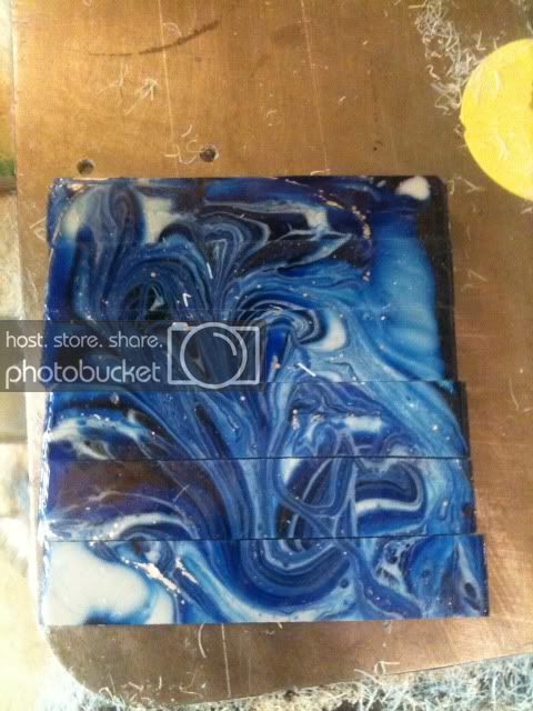

Casted today. I have bubbles initial but I will try again
I had air leaking out so I had to unpressurized it and sand the burr down and then I retightened it down with a wrench. I will post pics tommarrow
