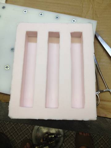

Well, after getting no response from a PM inquiring about Alumilite and casting, I dove in and got busy....

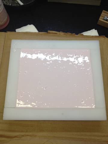

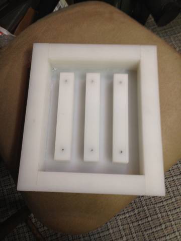

I took an idea from Curtis and made my MALE MOLDS out of Walmart cutting boards...
So far, so good....

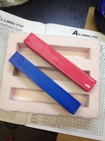

Then I used Alumilte's High Strength 2 silicone rubber....

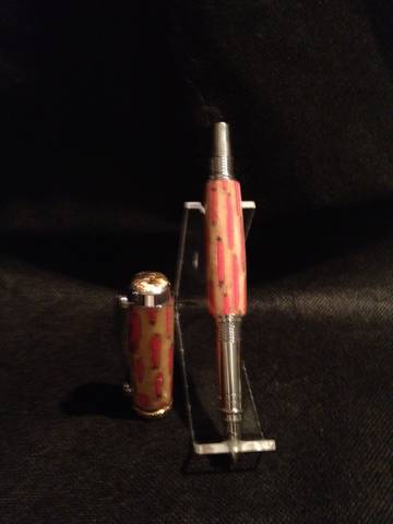

Hmmm, I think it came out pretty good!

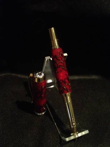

First casting, Cholla!!

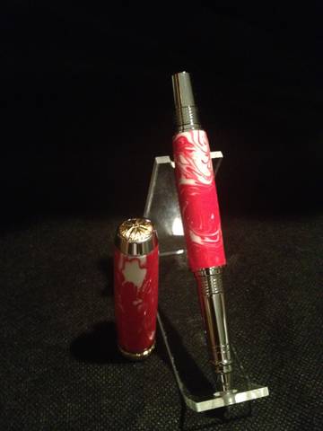

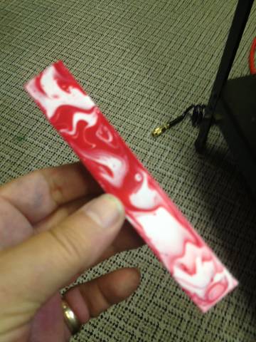

Then it was time to play around with multi colors and swirls, interesting..

I've really enjoyed experimenting with casting Alumilite, wish there was a color chart for mixing dyes though. This is the most recent cast, sweet gum ball. There is definately a difference in turning the clear. I really need a better picture taking set up!
