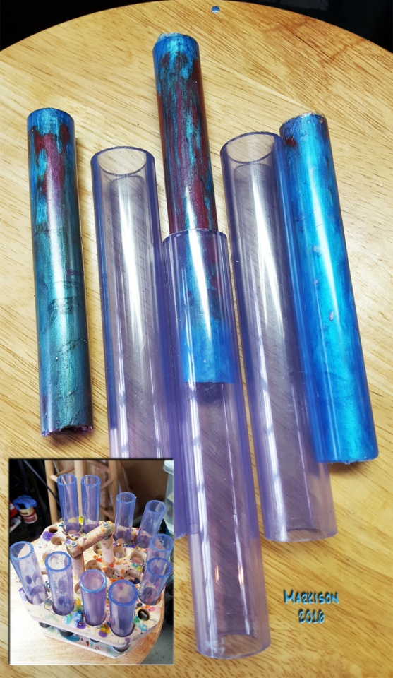

I stumbled onto this clear pvc pipe:
FORMUFIT P034FGP-UV-5 Schedule 40 PVC Pipe, Furniture Grade, 5', 3/4" Size, Clear
(amazon.com)
It has a light blue tint, but now I can clearly see my colors and inclusions, swirling and manipulating them with a wire as necessary under direct vision.
It works very well for PR casting - will try Alumilite with plenty of Stoner mold release later this week.
Warm regards to all - Bob

It seems like the clear PVC would take all the mystery and surprise out of casting. I could probably use a little less mystery and surprise in some of my castings. Thanks for sharing.

Ed - The technique just lets you dial the "mystery and surprise" up or down - probably worth doing some side-by-side trials of clear/manipulated PVC alongside opaque white PVC using similar ingredients - or maybe doing the clear with the lights out (while wearing casual shoes) for some maximal surprise.

I'll really be interested to hear of your results with Alumilite & the mold release spray.
From what I've read, Alumilite doesn't shrink while curing like PR and therefore doesn't work well for casting in PVC tubes. BUT if you find a method that works, please be sure to share your technique.
I've made a few dozen blanks using alumilite cast on PVC pipe. I don't use any mold release.. at all. I use 7" pipe and fill to the length I need usually leaving 2" of free pipe. After curing I take my tape (or rubber cork) off the bottom. I flip the pipe over so the previously taped side is facing up and use a rod of whatever size will fit in the pipe an hit it with my hammer. Sometimes it take a hit or two but once free it moves somewhat easy. I take it to my vise and open it to where the blank just fits between the jaws and have at it til the blank is on the floor. U can use the pipe over and don't even need to clean it up. I've isws the same pipe a couple times and the come out te same every time!
Clear PVC might just have to be my next purchace lol. My only problem... I have all the free pvc I could ever want at work...
I have used these to pour into. Baby Soda Bottles - Giant Test Tubes | Steve Spangler Science . At .80 apiece not to bad. I drilled a small hole in the bottom and used air to push the blank out. These are actually what they make soda bottles out of. When heated in a mold and injected with air, they become thin soda bottles. They come with the caps and a neat little stand to hold them. P.S. In looking at the web site, they may not come with the stand but mine did when I ordered a couple of years ago.

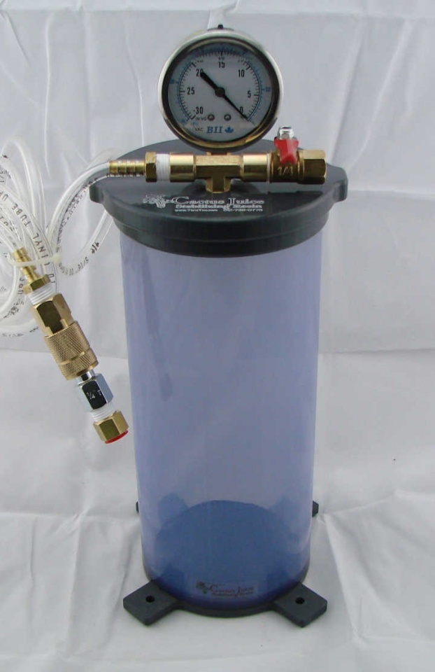

Clear PVC also makes a great vacuum chamber for stabilizing.
