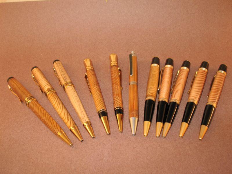

I have turned several pens from old salvaged heart pine. Thw wood was very dry and stable. It had tight growth rings and turned easy. On the sanding, the areas between growth rings are a little softer and tend to cause a small dip.
Also, be cautious of the resings in the heart pine. I found out the hard way that I had alergic reactions to it when cutting on the table saw. Not a problem when turning with dood dust collection. So, wear a respirator if you dont have a DC.
The picture is an example of a group of pens for a client from 150+ year old pine salvaged from a building. You get some interesting grain pattersn and a golden sheen.
