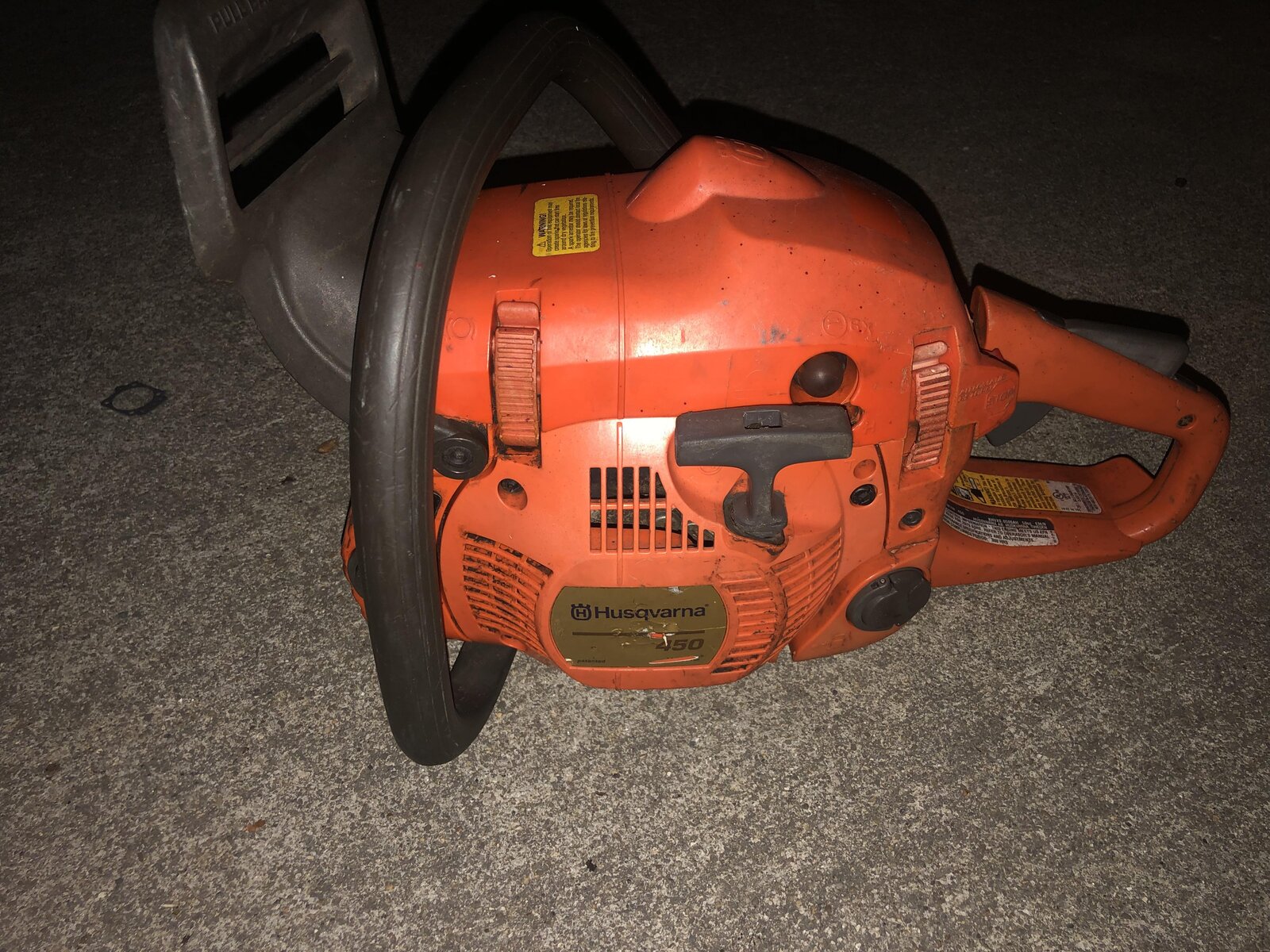

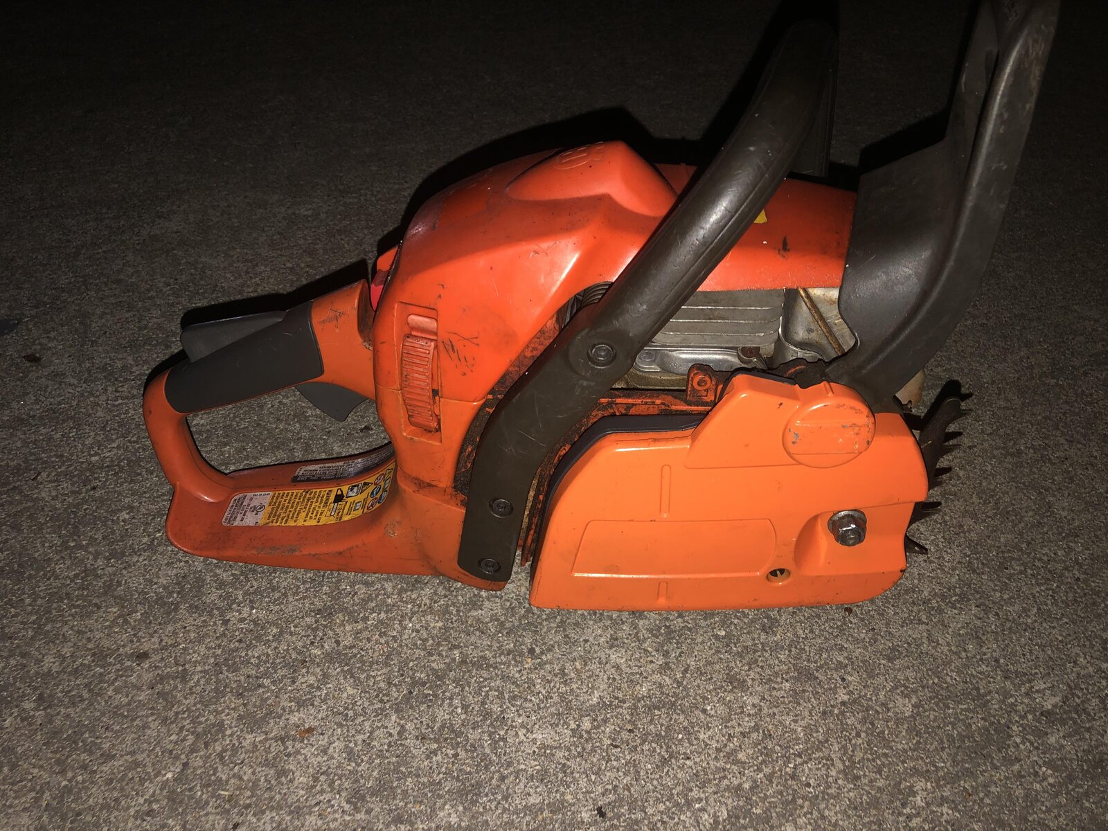

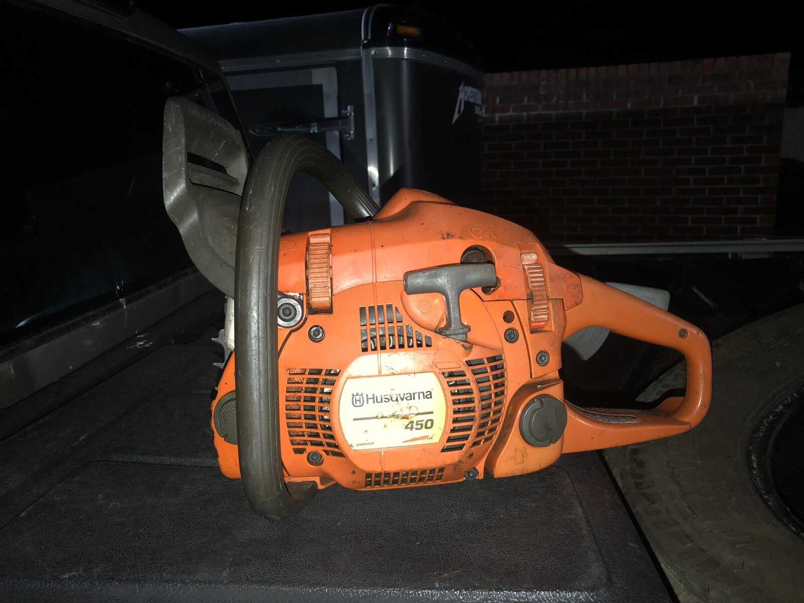

I'm looking at getting a used chainsaw and since I want a 20" bar I'm considering this guy's Husqvarna 450. He sells a good deal of this stuff on marketplace. The pictures of it don't look bad, and I've heard nothing but good things about H chainsaws. So when I go to pick this thing up how do I go about putting it through it's paces? I got a crappy Poulan chainsaw a couple years back and got jipped. It started and cut ok, but it got hot and bogged down with throttle and was useless. I'd rather avoid going through something like that again. Here's what it looks like..
