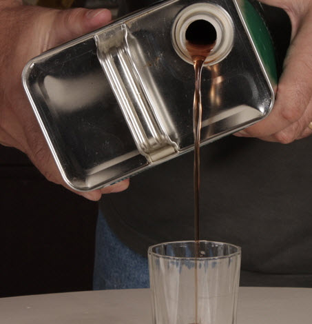

I buy mine by the 5 gal bucket. I pour into a 16 oz cup, slowly and allowing it to run down the cups inside wall so to not make any more bubbles than I have too.
Pour with the opening up (so air enters the top of the opening). That way it will pour smoothly and slowly.

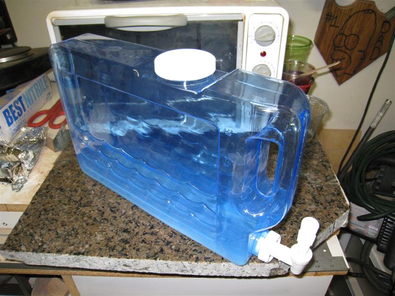

I bought a drinking water dispenser from Wal Mart for $6. The recycle number on it is a 1. It is 1.5 gallon container with a valve in the front and a large opening to pour in the PR. There is a larger size I think 5 gallon. I have had A cup of PR in it testing for 2 days now and it seems to hold without dissolving.
When letting the PR out will need to open the top lid slightly to let the air in. I will put a picture in later.
This sounded like a good idea so I bought one of these last week and dumped what was left from my can of Silmar 41 (about half a gallon).
Looked at it this morning and the Wally World container is getting soft so I have got to find something else QUICK!
