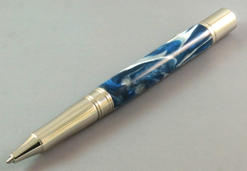

Here's one I made Using Dark Blue, Silver and White. I got the dark blue doing what I describe above. You can do the same thing by adding black to blue, but I had the blue darkstar, so that's what I normally do.
I just added The blue darkstar to my regular blue till I got the blue I was looking for.

Bob, that is beautiful. I was kinda going for that swirl on my first try, where my three cups of PR instantly turned to "colorful snot". This try I just did three separate layers.

Thanks Michael. Anybody who pours has had their share of "colorful snot" failures. It's just part of the territory of pouring. The more you pour, the less it happens, but it still happens.
