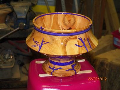

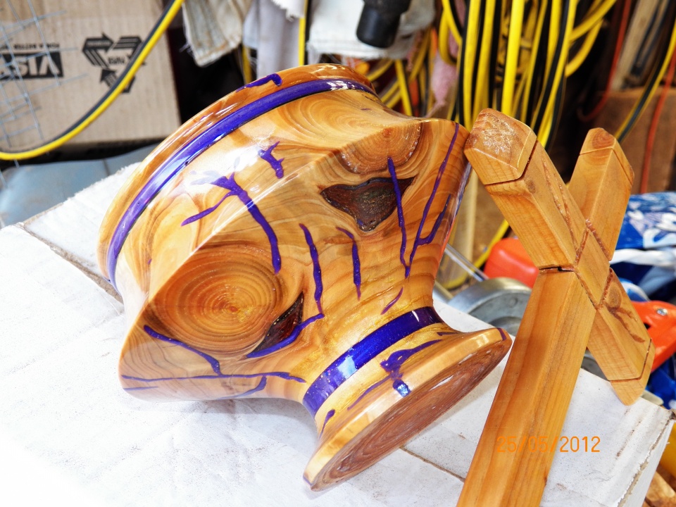

I have used lots of 5 minute epoxy glue with the Pearlex powders I use for my PR castings and you can't tell it appart from the actual PR resin. Sometimes we need to make a fill that is almost impossible to make a mold for and the coloured epoxy is what I use.

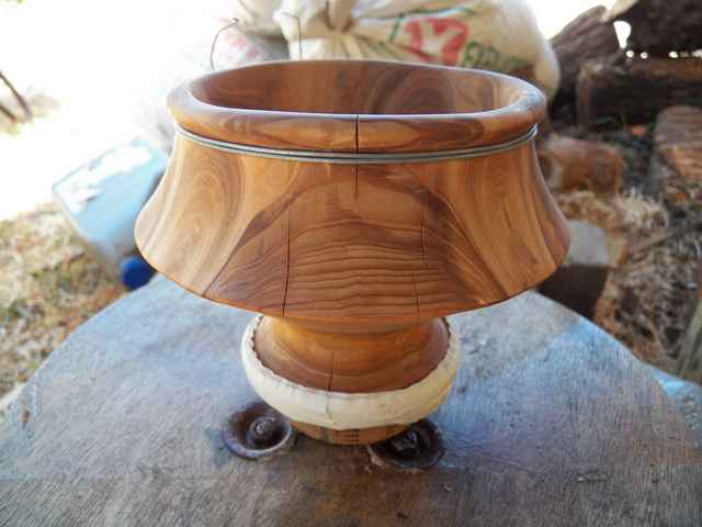

To see what it looks, I bring a pic of a piece that salvaged from wood separation and lots of cracks, that I worked on with a Dramel tool. There is a piece on wire wrap around the neck of this vessel, the wood totally separated to almost unrepairable but, I got it done...!
PS: Pearlex normally sells small 3gr containers with sample powders, they cost about $3 here in Australia and are a grate thing to have in the most base colours to take care of any needed repair/fill...!
