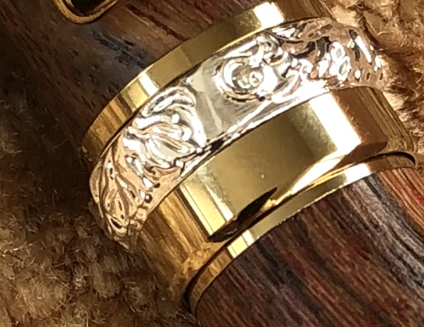

I recently assembled a Cabridge. Had a similar issue. Did not take a picture of the assembly problem, but do have a shot of the problem being solved. This is as tight as I could crop it. I screwed the bottom into the top and then gently forced the two together which moved the black plastic portion into the proper position.
Well, I finally bit the bullet, took a deep breath and pressed the pen together. WORKED!!!!

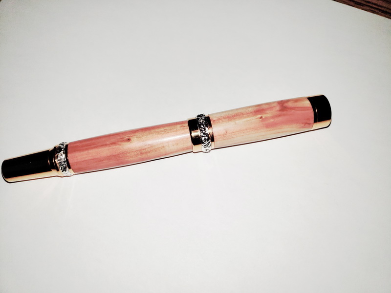

This is a dry branch from a giant sequoia. CA finish and matte with 0000 steel wool. It started about 2-3" in diameter. The wood is very soft as you would expect from a fir. Don't know if I like it or not. OOPS, FP assembled without nib and ink fill. :(
Details: I pressed in both Nib ends using push blocks. Pressed in the CAP and clip. Then threaded in post end. Threaded black sleeve and trim rings onto nib end. Aligned everything and gently squeezed in work working vise with wood faces.
