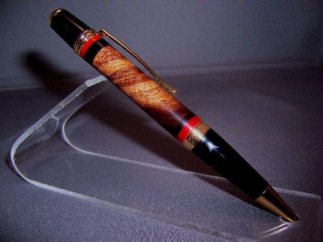

Sierra time
I just finished this one. It took about 1.25 hr. I did add some acrylic on each end
Koa blank
Nick
