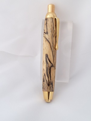

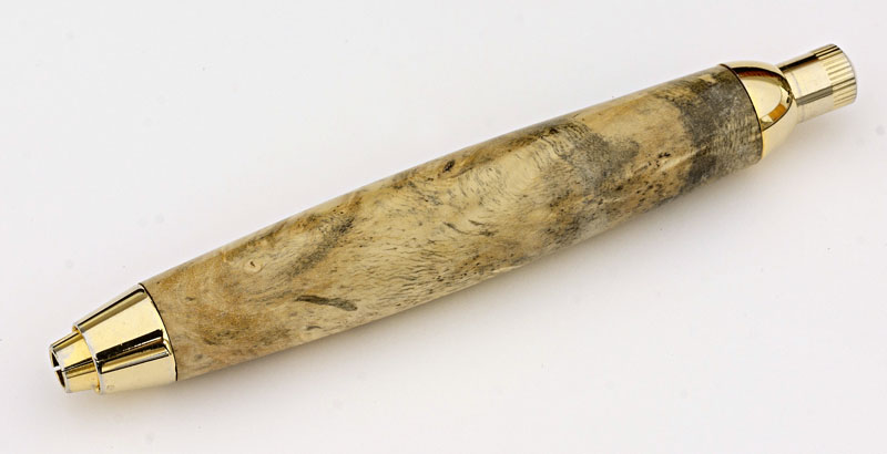

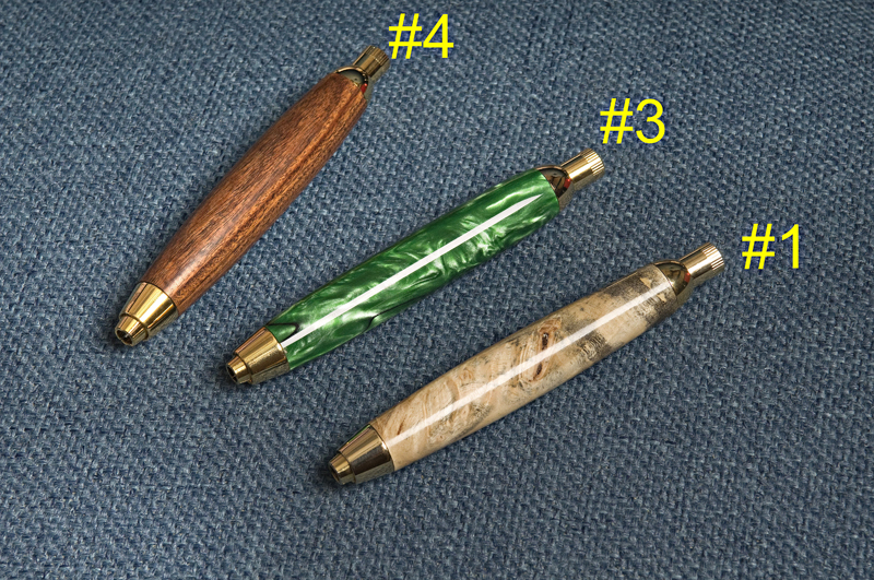

There are also some drastic differences between some commercially available stabilized blanks and the "consumer" stabilizing. I have a sketch pencil I made from a stabilized Buckeye blank from one of the BIG online pen supply companies that I treated just like an acrylic blank (wet sand + micromesh, no other finish) and it has held up amazingly, even spending an entire New England winter outside in the snow (lead was shot, hardware finish worn, but the wood still looks and feels fine, maybe not quite as shiny...don't go by the photos, lighting is drastically different between shots). I would not expect the same from a home stabilized blank, or one from a smaller vendor/supplier, as the stabilizing resin, and more than likely much more of the process, is different.
Before (#1)
After
There are also some drastic differences between some commercially available stabilized blanks and the "consumer" stabilizing. ......

Of the blanks you showed, one looks like Cocobolo, which won't stabilize properly, another an acrylic, doesn't stabilized as it already is, and the Buckeye, the prime candidate. Soaks up the juice like a dehydrated triathlete in Kona. The key is using the correct wood for the process.
The photo of the 3 pens is the only one I have of the Buckeye pencil when it was brand new, I don't remember what the other wood pen was made from but it, and obviously the acrylic, were not intended to be part of the conversation, they just came along for the ride by being in the photo...
My point was that while I don't specifically know what resin some of these big companies are using to stabilize their banks, my impression is that it is very different from the resins sold for the home stabilizing market (and used by both small and large vendors in some cases), of which there are several including the one you mentioned. My experience with them is that there is a significant difference between the two.
