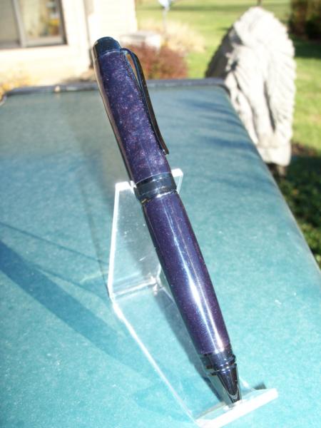

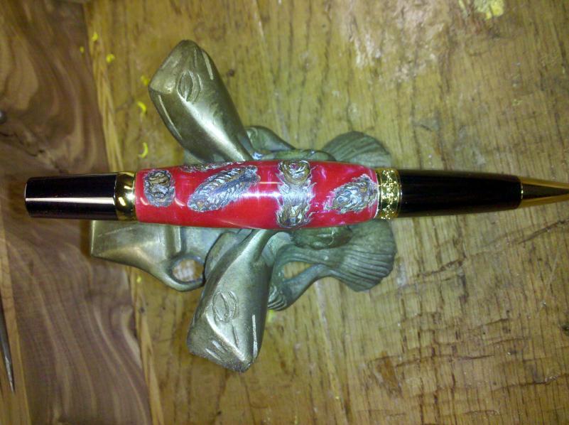

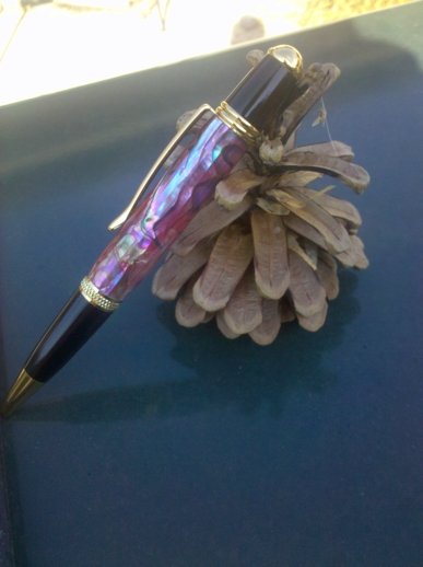

Gil I casted many cast but I don't use a pressure pot. So far I have done snake skin,abalone,cholla,pinecones, my treat is room temp. on PR stir but gently in one direction,keeps bubbles to min. when pouring pour ONLY in one corner of the mold keep bubbles down to a min. and if you get some bubbles just gently poke them I use a dental pick. Good Luck pouring!!! G with you AZ temp you got this lick !LOL.
Here in Illinois were at 9 degrees right now so I have to wait a while before i can pour in my garage. Louie56

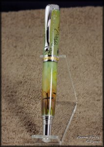

This is what I'm casting. This was my first try...my wife will be painting more tubes now with various themes...so it's all clear casting... I might have some fun on the side though...I ordered 7-8 colors or mica.
Gil
