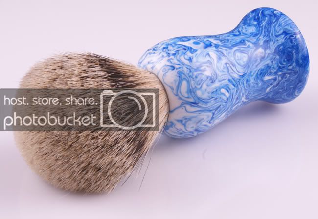

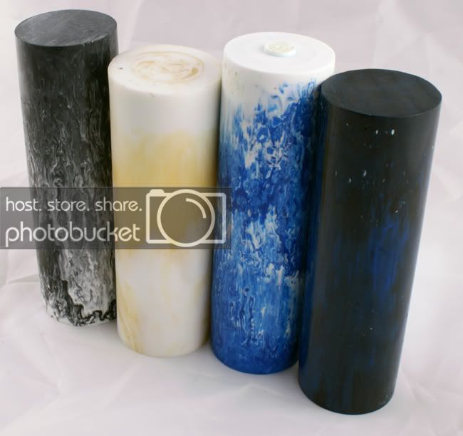

Here are some examples I have done.[/FONT]

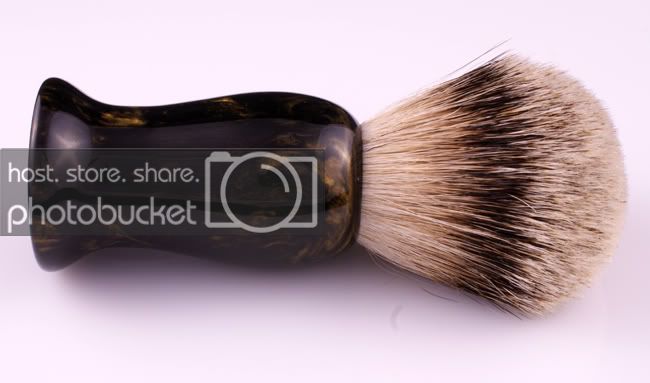

[FONT=&quot]The shaving blanks are 50mm (2") blanks I then turn these down to 45mm for sale also to reveal the inner colour effect. I hope this helps little.[/FONT]
finished at 45mm
