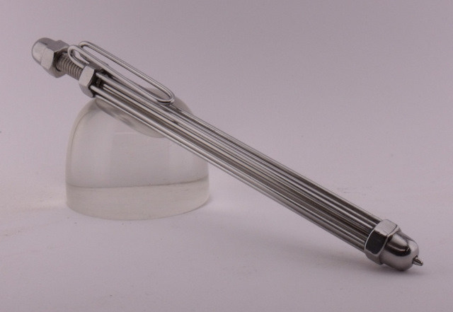

I went down to the shop today to get some CA......and while I was there, they had a deal on some Butane brazing torches, so I got one and some flux etc.
(I had to go back later for the CA that I forgot:redface:) You know what it's like.:wink:

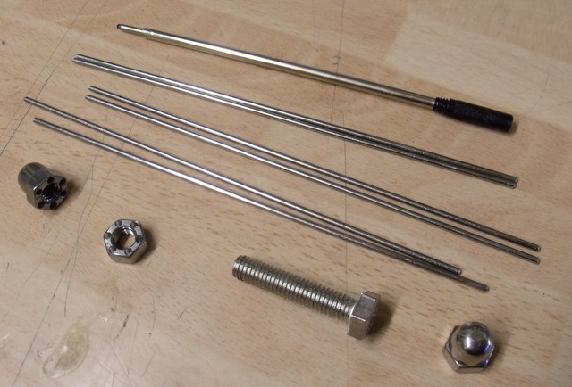

Now I had to find a use for the brazing gadget, so I made a quick pen similar to one I made a few years ago but this time I brazed the rods in the holes. Worked well, but took a bit of cleaning up afterwards.
I used two 6mm s/s dome nuts, one regular 6mm s/s nut, the thread from a 6mm s/s bolt and cut 6 lengths of s/s mig welding wire.
I later changed 2 lengths to one much longer one...(clip)
(6mm is about 1/4 inch)

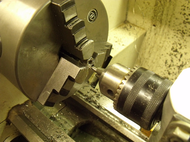

I could have drilled these little holes on the drill press, but I have toolpost holder for a drilling machine on my lathe so used that.
The threaded end screws back and forth to extend the refill. I put a very small spring on the tip of the slimline refill to retract it.
A fun little pen and a perfect excuse to buy another tool:biggrin:

How does that operate? Is it a twist without the transmission?
Lupe, the threaded end is drilled in the middle to hold the refill end without the plastic bit. ( just to keep it in place) Turning the top nut pushes the refill down. Takes about 4 turns though. :wink:

Skiprat now that is a cool looking pen, can you fill me in on the part where the refill is and how it works,i just can not understand how it works when turning the nut.

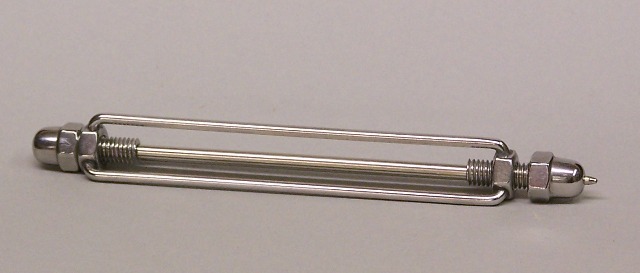

Skriprat please tell me where the regular nut is located on the pen, PLEASE!!!! I'ts driving me crazy trying to figure it out.
I can see the dome nuts location & the bolt with threads but where is the reg. nut???
Louie
Louie
LOL Louie,
The head of the bolt was cut off and replaced by the dome nut. That was just to give both ends a rounded off shape.
The threaded section has a small hole drilled in the end to keep the refill located.
The regular nut is what you think is still the head of the bolt.:wink:
So now the threaded section ( now with a dome nut head) screws into the fixed regular nut to extend the refill. A small short spring pushes the refill back when the threaded section is unscrewed.
You simply just keep on unscrewing till the threaded section comes out to change the refill.:biggrin:
