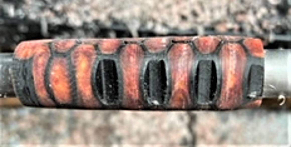

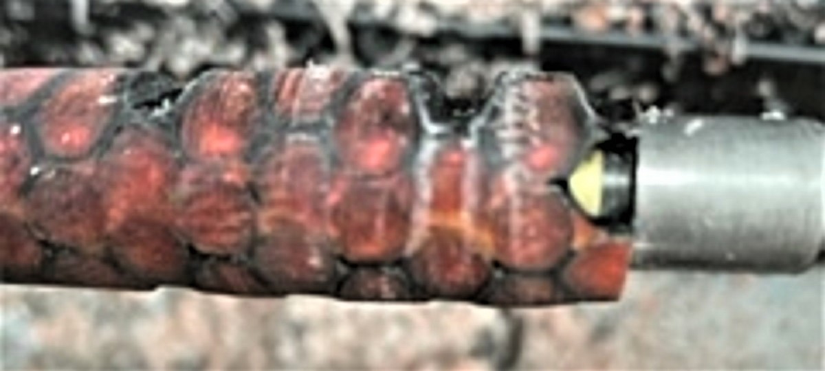

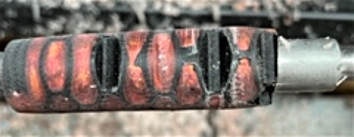

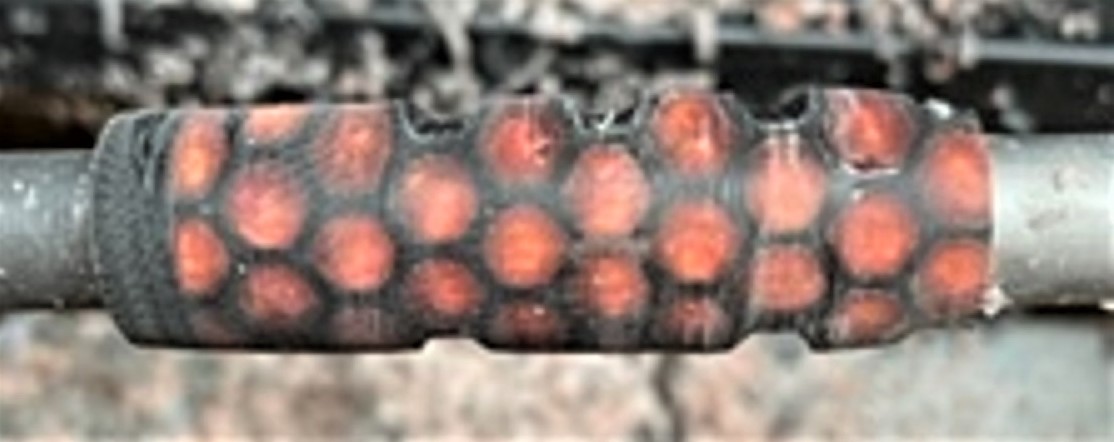

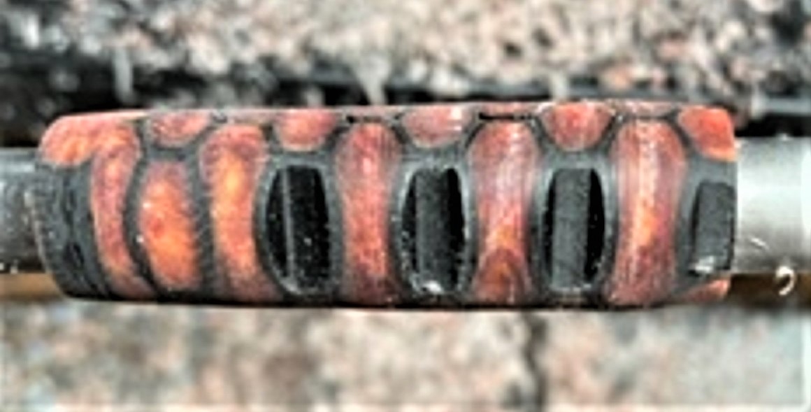

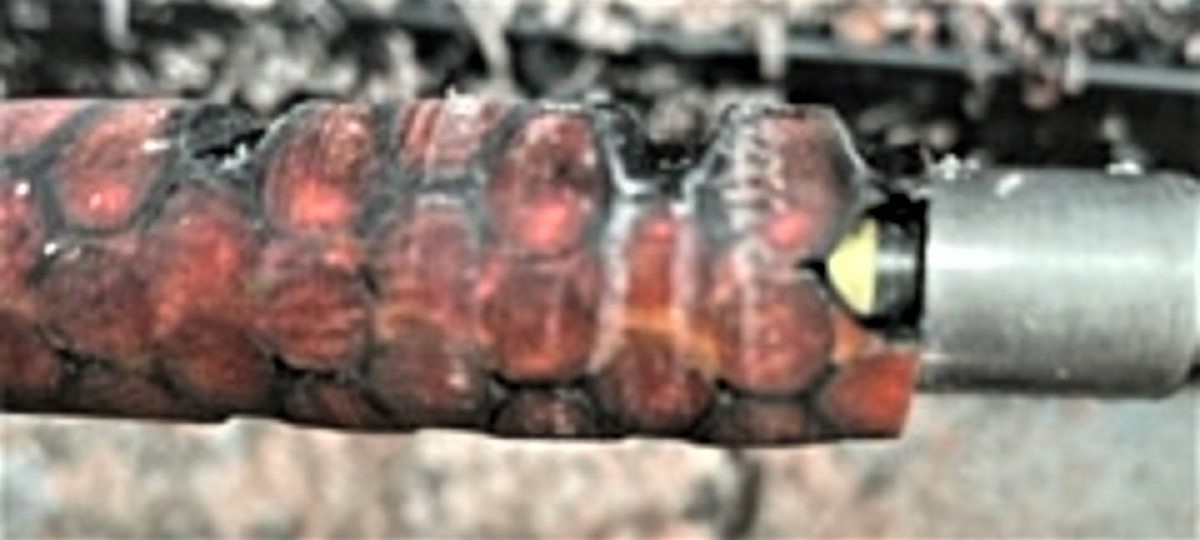

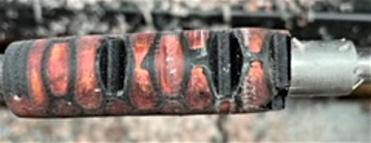

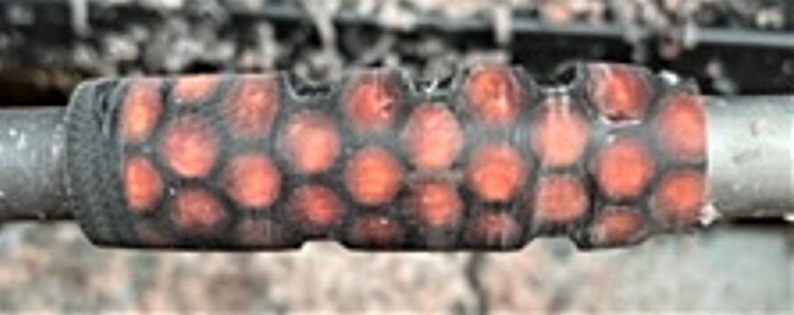

I seem to have a problem that has me a bit baffled. Ok I casted some honeycomb material awhile back using Alumilite clear slow using a silicone mold. Then, some time later, used the honeycomb in some pen blanks I cast. Months late drilled them out, glued in tubes and began turning them. The first two went fine but the third started to come apart on the lathe. The honeycomb is separating from the other material. This is not the first time this has happened. Has this happened to anyone else? What causes it?

Is this happening as you're turning? I've turned one that I purchased my experience was that it was very crunchy. I made very light passes and turned at a fairly high speed, it came out very nicely.
You might watch RJBWoodturner's You Tube to see what he has to say. Overall it's a very brittle blank that needs careful treatment. I think it's common that the cells will lose the material if you don't turn gently.
I'll see if I can find the link to RJBWoodturner's video.
Thank you both for your replies, I've tried fast and slow speeds. Doesn't seem to help either way. John your explanation seems to be the ugly truth of it. Oh well, sometimes when you swing you miss the ball. Lesson learned.

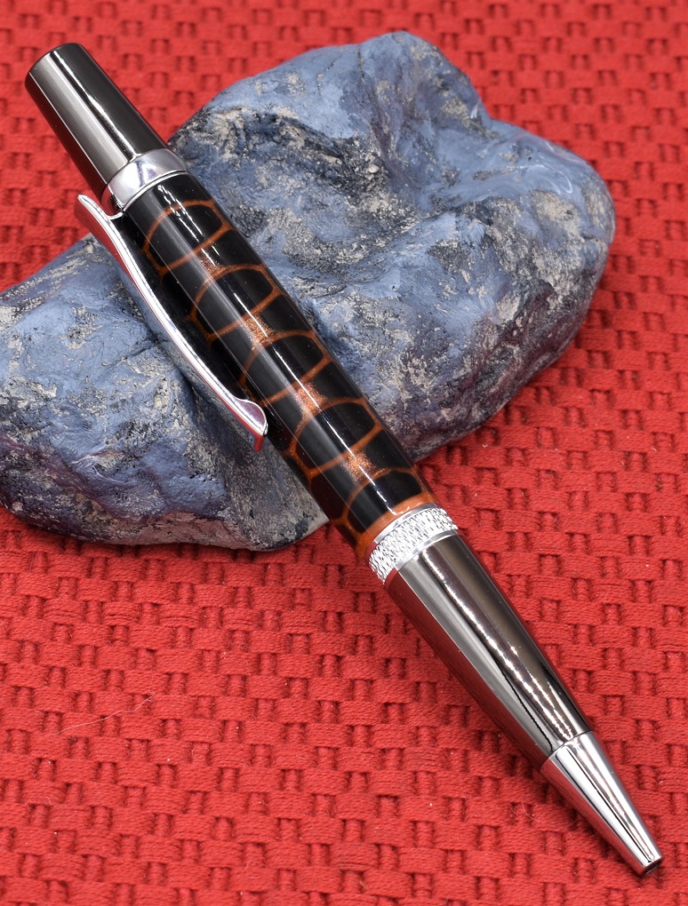

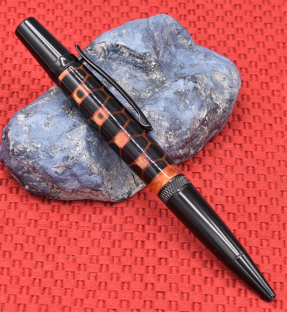

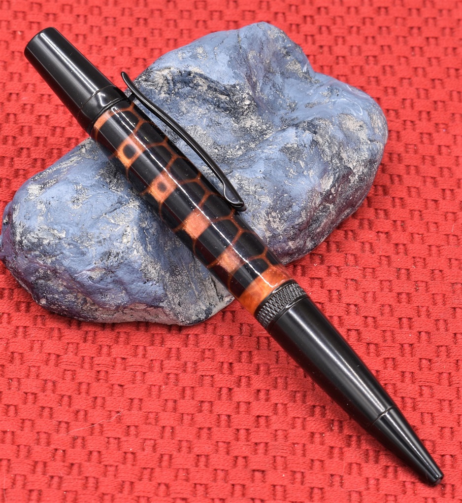

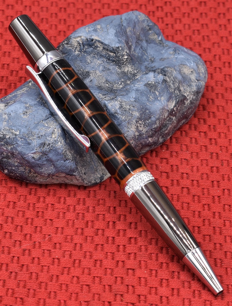

As I said I had two that turned out, here's a couple of pics.
