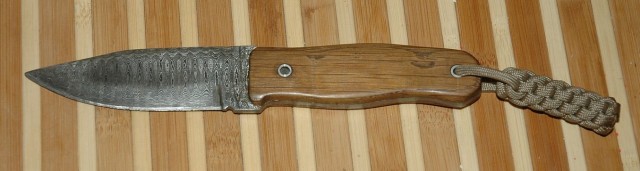

That is a knife:
s640x480

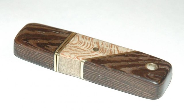

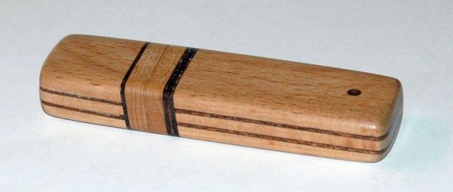

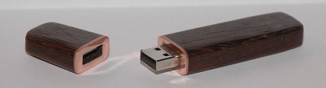

And thumbdrive:
s640x480

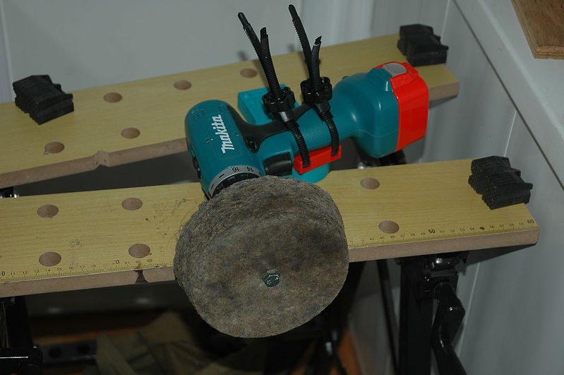

First "sander" was screw gun with clamp and 125mm (5") sanding disk with box as table.
I have no photo with disk, but there is photo with felt disk.
There was a lot of disadvantages (noise, low accuracy and control etc...) so I decided to make "real disk sander".

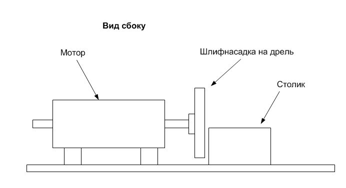

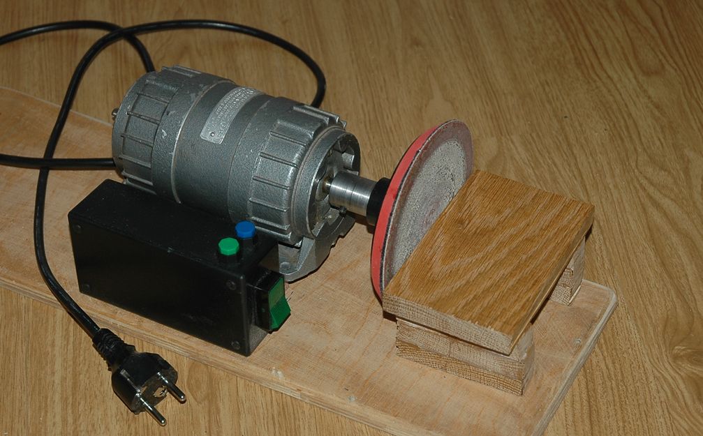

Draft:
attachment.php
Writing means: Side view, motor, angle grinder velcro disk, table.

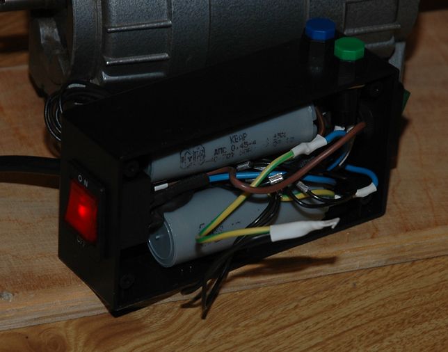

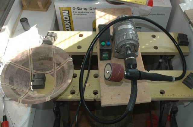

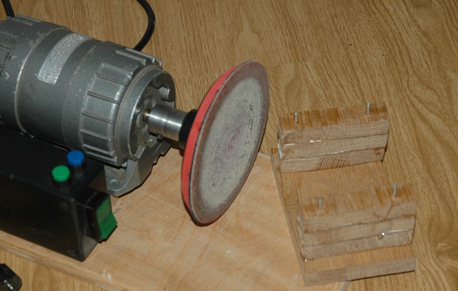

I took 90W 3-phase asyncronic motor (2750 rpm), made control unit for it. You may see main power switch with LED (left), reverse switch (right),
ON/OFF switch (green on top) and start (blue on top).
I used 12 mm (1/2") plywood as bed.
Quick-removable table holds with 4 pins. It allows to change velcro sanpaper very quck.
Also I found turner, who made for me metal sleeves to fit sanding disk on motor's shaft.
Motor is quiet and low powered (about 50W on 1-phase), that is enough for small things like knife handle or thumbdrive.
Main disadvantage was softness and flexibility of sandind disk. Also table had no angle guide (it is senseless for flexible disk).
But soft disk had advantage - it was very comfortable to make curves and I made a lot of things on that sender.
Also I can attach Jacob chuck and use buffing wheels.

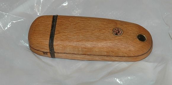

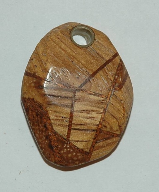

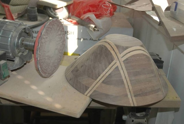

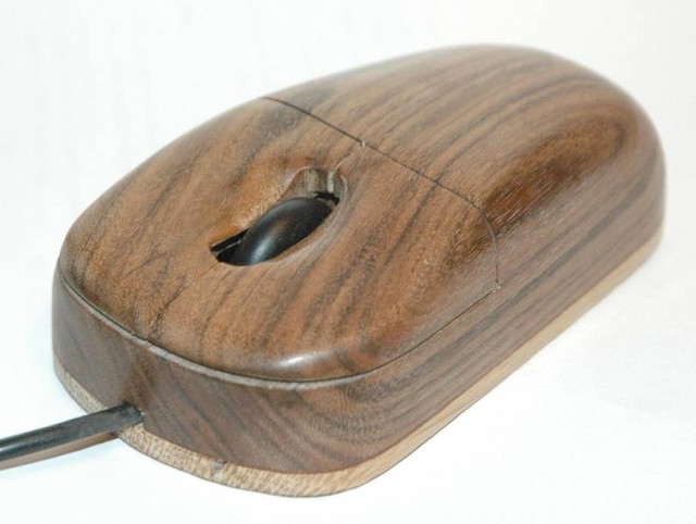

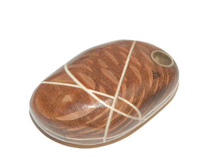

Stuff made on that sander:
0001bq5a
s640x480
s640x480
s640x480
s640x480
s640x480
0004fpe3
s640x480

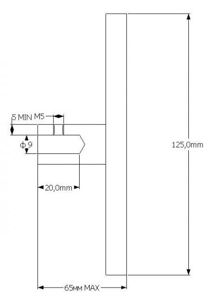

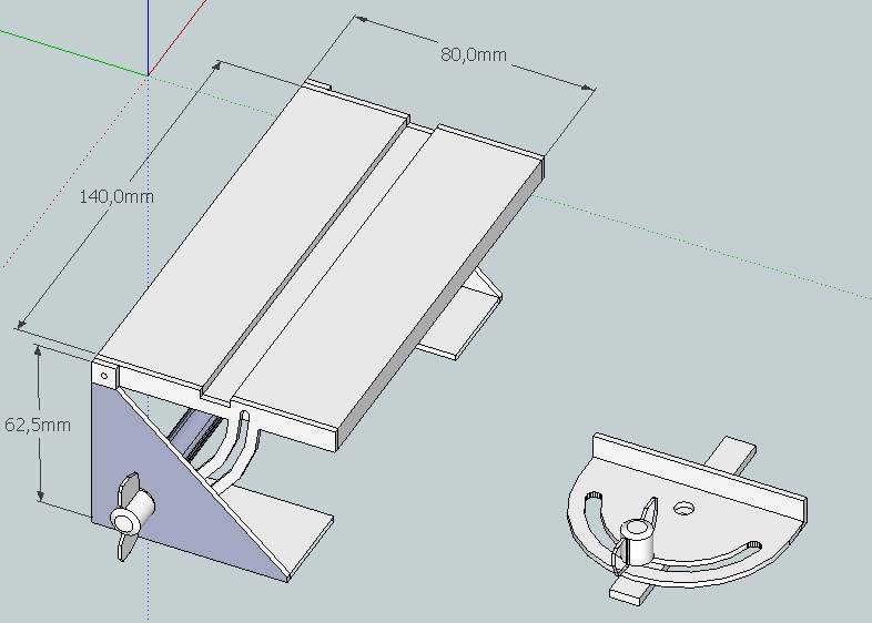

I have looked for firm disk, but disks for angle sander was flex or curve. So I decided to make new table and firm disk.
Bellow is a design: table with rotating mechanism, angle guide and disk. I gaved that drawings to turner and he made for me disk, angle guide and table.
I used 15 mm (5/8") plywood and 5 mm (1/5") textolite (micatra) as sander bed.
Same contril unit, plywood disk with velcro.
Now sander much bigger and I cannot store it on windowstill. :)
But now it can be called sander.
Drawings:
attachment.php
attachment.php
attachment.php

Wow,you do great work! I like how the table swings away to easily change the paper,very nice design.
Your woodworking projects look really cool,my favorite is the wooden mouse.

Very nice! Are your thumbdrives from kits, or are you just buying them and taking them apart and making a new housing?
I buy thumbdrive and disasseble it. bensoelberg gaved link to my topic about it.
Do you need detailded how-to guide?
Really cool. Need is the mother of invention. Great segmenting by the way.
I have wrote about it already. There is a link http://www.penturners.org/forum/showthread.php?t=79868 .

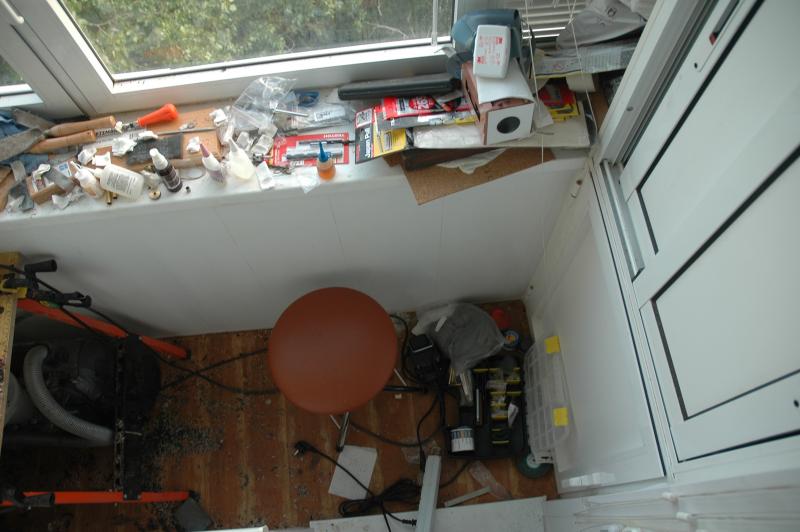

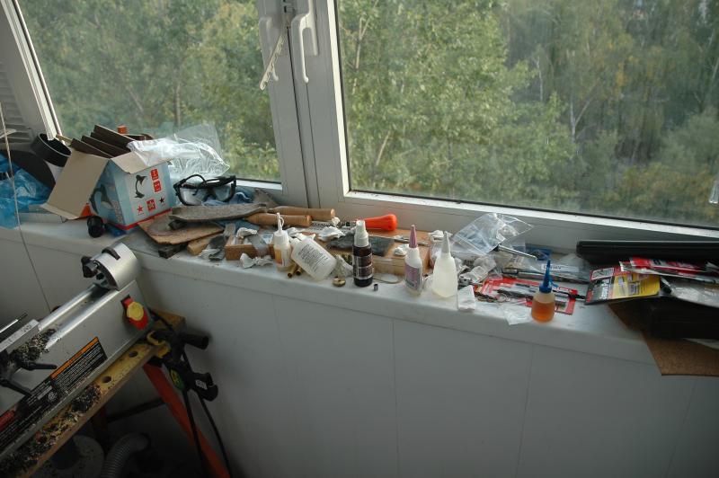

Ha... Two car garage... You have a lot of place.

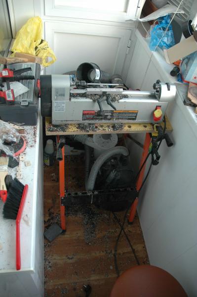

There is my "workshop". Sorry for mess. :)
attachment.php
attachment.php
attachment.php
