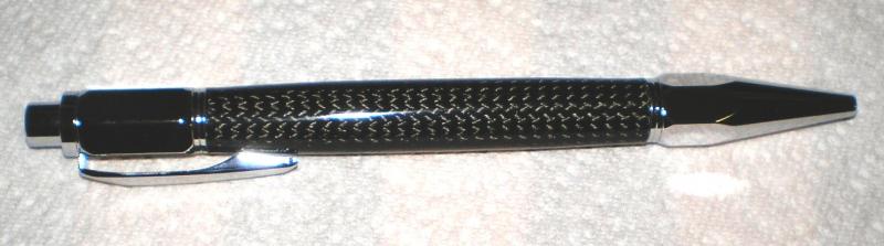

that is my new woodchuck for pens from Ken (bitshird) that arrived today. I decided to test it on a carbon fiber vertex blank as I just got a request for a carbon fiber shop pen from a motorhead. WOW, 5 minutes from start to completion of pen. That tool cut so fast and smooth I would not have believed it if I was not the one using it. Took the blank right to size and needed NO sanding. I went from turning to EEE polish and assembly. 5 minutes to make a pr pen. Unbelievable. Turning will never be the same. Thanks Ken. I am including a picture of the pen. I did not sand or micro mesh, just applied EEE after turning to size. I am still having a hard time believing it, I better go turn another pen.

I bought my carbides off Ken and they are great. I get ribbons off antler as though I am turning acrylics. And acrylics turn like butter.
WOW! That is a cool pen, but i am blown away at the sanding claims! I gotta getta woodchuck! Now i have a reasonable argument for SWMBO! "But Baby, Think of all the money and time i will save not messing with micromesh, You know that crazy expensive sandpaper i like so much!"
I also used my Woodchuck for the first time today. I was amazed at the ease in which it cut an acrylic blank down. Far superior to standard tools.
Tom
*sheesh* I am going to have to get one of those too...that is an unbelievable claim. But it was backed up too. I am never going to have money am I?
Pen turners can expect to have money??? :smile: Also remember that the blank used with the 5 minute pen was one of my carbon fiber blanks that already have the tube in when cast and come off the shelf with the ends already squared. All I needed to do was plug in the bushings and put it in the lathe. An acrylic blank that needs to be drilled, glued, trimmed and squared is going to take longer, but the turning will be incredible.
