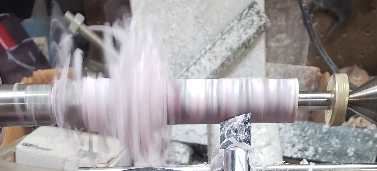

Since I started using a carbide chisel held at an angle to get a "shearing" cut, I haven't had any problems with inlace acrylester. I turn at 2500 rpm.

Just like Jim's (qquake) experience, since I started using a carbide chisel held at an angle to get a "shearing" cut, I haven't had any problems with inlace acrylester. I turn at about 3500 RPM though. My first "shearing" cutter was a Magical Skew from T. Shadow. Since then I have built my own "shearing" tools using hex shaft instead of square bar stock so the carbide cutters address the blank at an angle. As with the Magical Skew they provide more of a "shearing" cut than one would get from a standard "scraping" carbide tool. This can also done using standard carbide tools by holding them at an angle on the tool rest. Jim's picture illustrates this exceptionally well.
