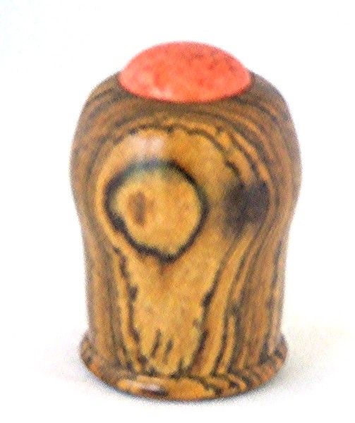

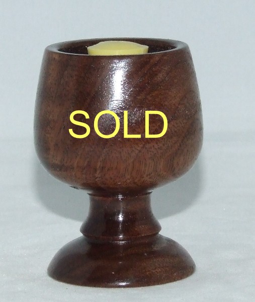

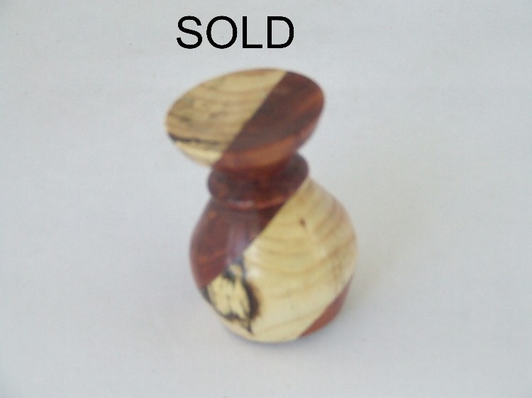

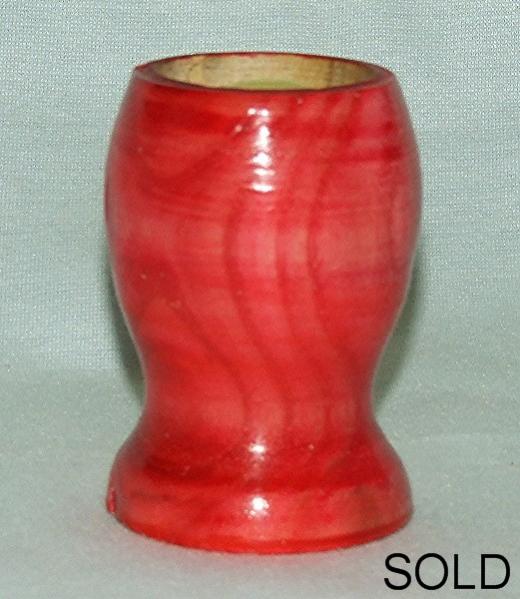

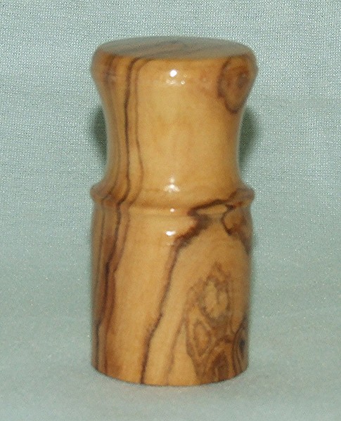

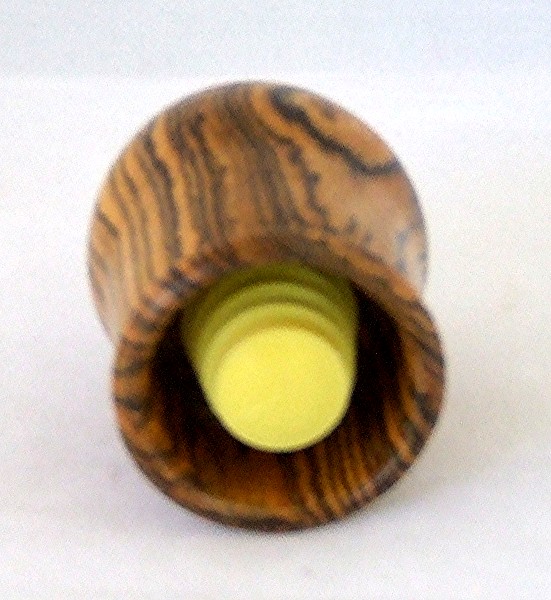

They're really simple to make, lots of fun, lots of design possibilities and I find they are well received at my shows....
attaching a couple of photos to show some I did..
