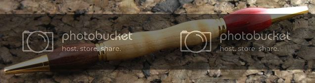

I have a bunch of fiddleback hickory that is anything but boring. You will find there is quite a bit of chatoyance in hickory and if you can play this up, possibly matching it with some other darker woods, it will be really nice. It turns like butter, as well. Here's a pen using the curly hickory.

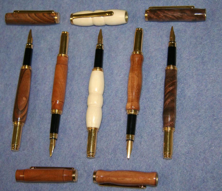

I grew up around wood of all kinds - Dad had about 80 acres of original growth until my teens. Dad also made pallets and skids in his retirement years and put lots of wood aside for me. Hickory was one that mystified me in the colors. I had some clear almost ash like creamy white (as in the Teachers pen posted above), some with reddish brown streaks and most with a slightly dark beige color. Also something that bugged me was on several occasions people offered pecan as Hickory and claimed it to be the same family. Some boards do look alike.
Turning: I have only turned a few hickory but they turned well for me without any problems.
Below (second from right) is the hickory pen with in the dark beige (heartwood) hickory that I did 3 years ago as woods from Louisiana for a friend. Those were with calligraphy nibs.

Yup, Bolivian rosewood and bloodwood on the ends and curly hickory in the middle. I bought like 100 5/8" sq by 12" blanks on ebay years ago. I gave a bunch away but still have quite a bit. Big Rob had some fiddleback hifckory 3/4" blanks for sale that looked just as good, if not better than this.
