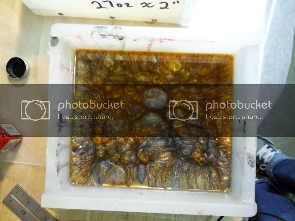

Hi, I'm Brad, and I'm now addicting to pen casting.

Hi Brad, very nice looking blanks. Do you have any video of how you achieve this effect? How much resin are you using to get 5 blanks? Have you tried casting in tubes? I get 18 x 3/4" blanks from 20oz of resin when done in tubes. I have some of the 9oz oblong molds that give 3 blanks @ 3/4" but they are far too wasteful.

Wow!! Looks great Brad. Never could get the hang of horizonal molds. I use mainly PVC in vertical. What is the secret?????????????

Thanks! I want to say I'm using 12.5 oz for this one cast, but it's on the thick side, so I'll probably take it down to 11.5 oz. That gets me five blanks that are >3/4" square and 5" long. I don't have any video; I simply watched all that I could find on YouTube on PR casting and adapted to suit what I have on hand. I haven't tried casting in PVC yet, but that's my next thing--I want to start selling these, and need to figure out how to sell them at a good price AND make a profit...I have a motorcycle trip this summer and I promised the missus I'd do my best to pay for it through pen sales. This is just an extension of that desire.
I read your page, and have seen videos on YouTube explaining your method. My problem is that it's in the teens and low twenties right now. I have an attached garage I work in, which means I have to leave the garage door open when I pour, else the house stinks. I can put the square molds in my toaster oven and have them cured an hour after I pour...I don't think PVC tubes standing up will fit. I'll figure something out, otherwise it'll take days, at best, for them to cure at these temps.

I tried casting in PVC over the weekend, but found that I can't get the same swirling patterns. Oh well. The round saves nearly a whole ounce of PR over the square blanks.
Now that I know that, I can continue on. I've ordered another gallon to keep going (I burned through that first gallon quickly while experimenting). I've also ordered more colors of Pearl Ex. I'll soon put an ad up in the Classifieds here selling them for $3.50/$3.25 individually/5-pack once I have a good, varied selection of colors.

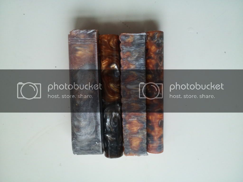

Okay, so I think I've figured out my method--Wait until it *just* starts to gel, pour in the first color, then pour the other color over that. Swirl like you would marble a cake batter, and then toss in the oven.
Whatcha think? I didn't polish the second one, just wet sanded with 600 to get it smooth.
...the Silver and Gold?

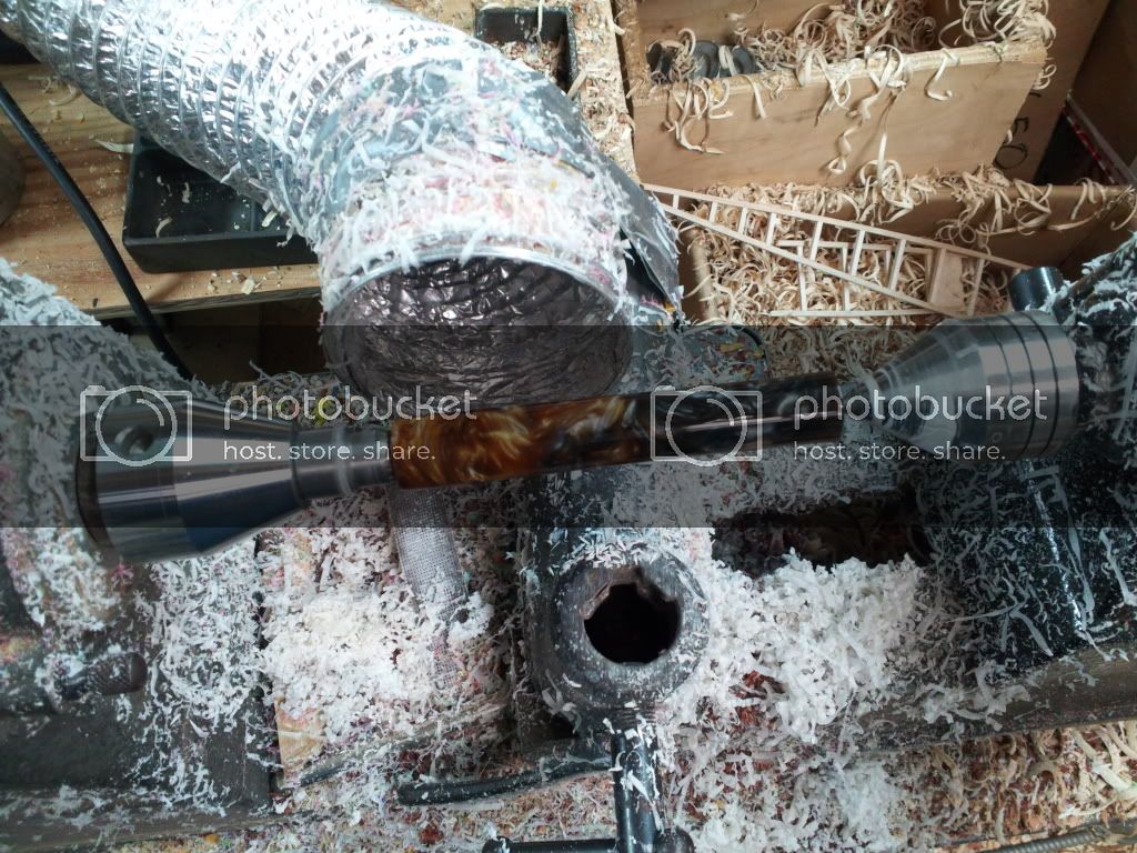

Yes, and the second one from the left became this:
Mike--
No, it's a 1971 Delta Rockwell 46-201 that I found on CL a few years ago.
