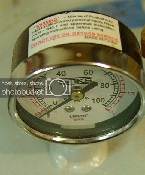

Which parts? Not seen any with made in China stamped or printed on mine. Then again, mine are a few years old.
I guess I missed this question when this post originally came out. All the guages of my Binks tanks are labeled with a "Made in China" stamp.
