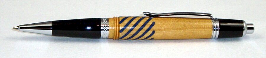

Thinking about the diameter of a pen, any more than 24 index positions would be severe overkill. Take a look at how close the cut lines are in this pen with just 8 spirals (every 3rd index hole used)...and I'm using a 1/32" cutter on this pen. I'm thinking that any more than 12 or so cuts (every other index hole), the cut design would run together.

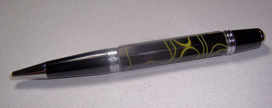

8 sided poly
I did an 8 sided Acrylic Sierra. Thied a Beal Buff to polish. Even going lightly, it started to round over the facets. Ended up using 600 grit wet, and auto body rubbing compound and a finish coat of Ren Wax
Photo on a previous thread.
