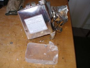

Hi All,
I left my PR in the cabinet in my shop. It has been an average summer, hot but not too brutal. Over the last few months I grabbed the can a few times to give it a shake and see how it was doing. Evidently I missed the point of no return. Not much I could have done anyway. I couldn't keep it in the house. And I don't have a fridge in the shop,,,,,,yet. So when I grabbed it a few days ago to cast a blank for my oldest Son, it didn't slosh in the can. When I opened it, this is what I found.
What a shame.:mad::curse:
Anyone care to trade a pint of hard PR for a pint of liquid PR?

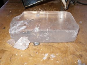

You might also be able to cast a 'doohickey' and cut this hardened material down and put it on top for a lens. Just a thought. I'm sure Yo-Yo Spin might have some other ides as well.
Something in my mind is not adding up--- I store my PR in plastic one cal gas containers and we've had temps for 5 days in a row over 105 and my shop got to 120 and today I've poured 6 cactus, 9 snake and 3 florentine blanks no problems. I actually make the pr thinner by heating it in my toaster oven at 150 degrees so it will penetrate worthless wood better. Now at 150 degrees it has not jelled but when the MEK is added it sets up much quicker so I've cut down on it to no more than 3 drops per oz. I wonder if the metal can had something to do with it setting?

Hey Steve , cut it into square blanks and make magnifier lenses out of it , turn them round and polish them and depending on the curvature of the lens you could get several out of that mess .
Just a thought .
I'd make a bowl out of it. I made a bowl out of an automotive urethane puck once, it machined like butter. I doubt the PR will machine that nicely but sounds like fun!
Cut it into blanks and turn it. You could paint the inside different colors for different looks.

Roy, This has been idle, except for my shake tests, for several months. It's also up wards of 8 or 9 months old. And sets near the top of the shop, just under the rafters, the hot part of the shop. I always try to close the cap as tightly as possible, but it's not the greatest seal in the best of cases. So, all in all, I got what I asked for.:frown:

Another good idea. Have to let it fully harden, It's still a little bit rubbery on the bottom side.
Heat is what cures PR, as proven by Steve, I remember reading somewhere that it will cure without any MEKP if enough heat is present,.
Remember how to cure blanks that are curing slow, put them in a toaster oven, Steve just proved it's true, Sorry Steve, I need to check my can there's about a quart and a half left, MAYBE
