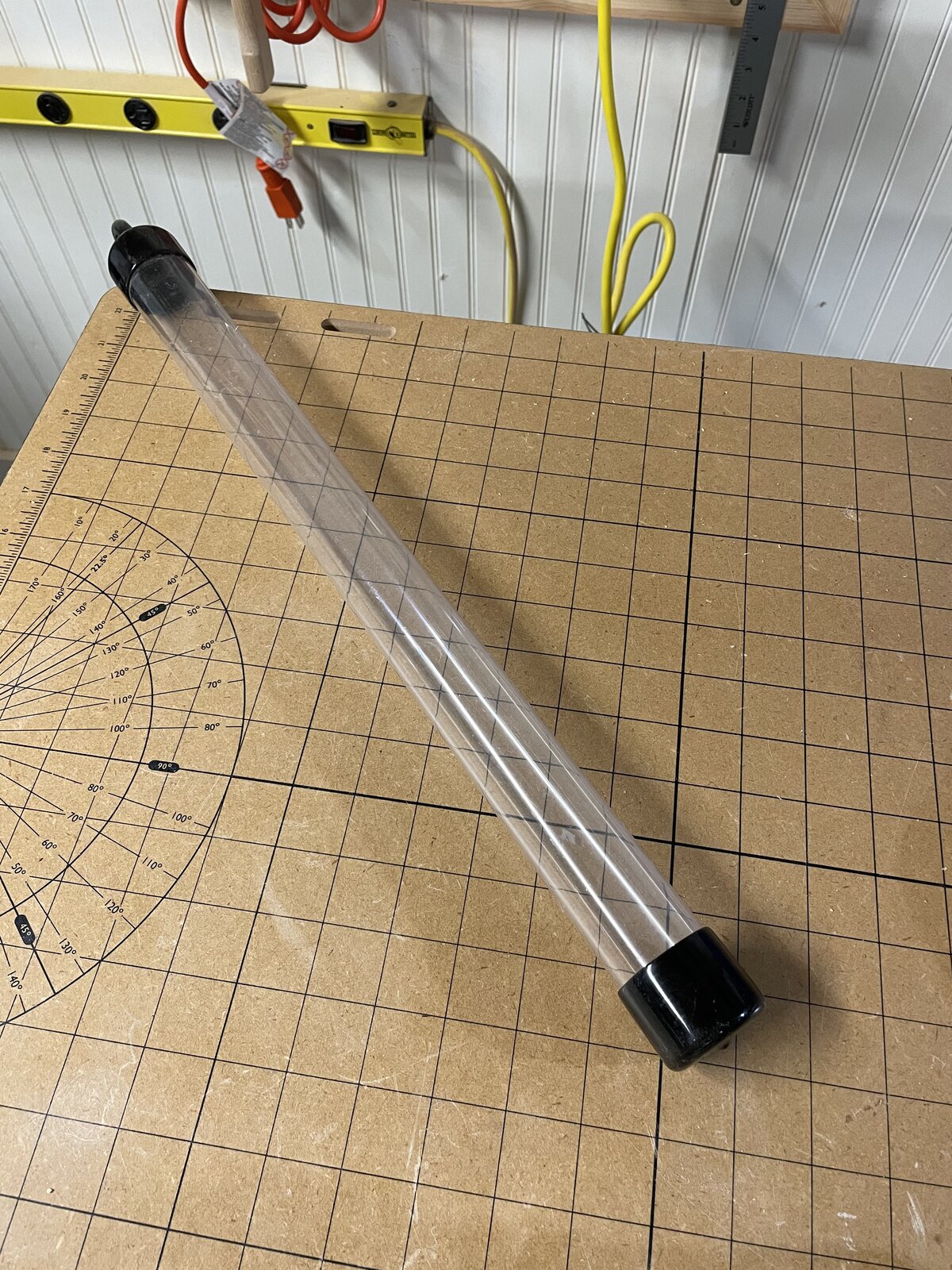

I got the idea of using those plastic tubes, such as t track come in for stabilizing and dying pen blanks. These ones are all green , but you could easily do a mix of colors. These are all green because this is the first try with this method. They have been going about 45 minutes and all looks good. There are 4 tubes with juice and the chamber is filled with empty ones just to keep anything from tipping over. This is using far less juice. Wouldn't be useful if they were clear as you don't lose any, but when it's dyed it's dyed. Just thought I'd share to the group. By the way, the blanks are 2 spalted maple and 2 maple burl.
Don`t know what those tubes are made of , but can tell you that clear thin tubes made from cellulose acetate butyrate will lose integrity after a few hours in cactus juice .
Good to know. They've been going for a little over 2 hours and everything's fine.

I started without 1.5 inches above the blanks. They've been going since 9 this morning and the tubes are working fine so they must not be the material that cactus juice reacts with. The new cactus juice formula foams way less than the original.
Update, 8 hours later, all bubbling stopped, vacuum released, plastic tubes I used held up just fine. They'll soak overnight and I'll cure them tomorrow after work. These are the first I've ever tried dying, hopefully they'll look good.
