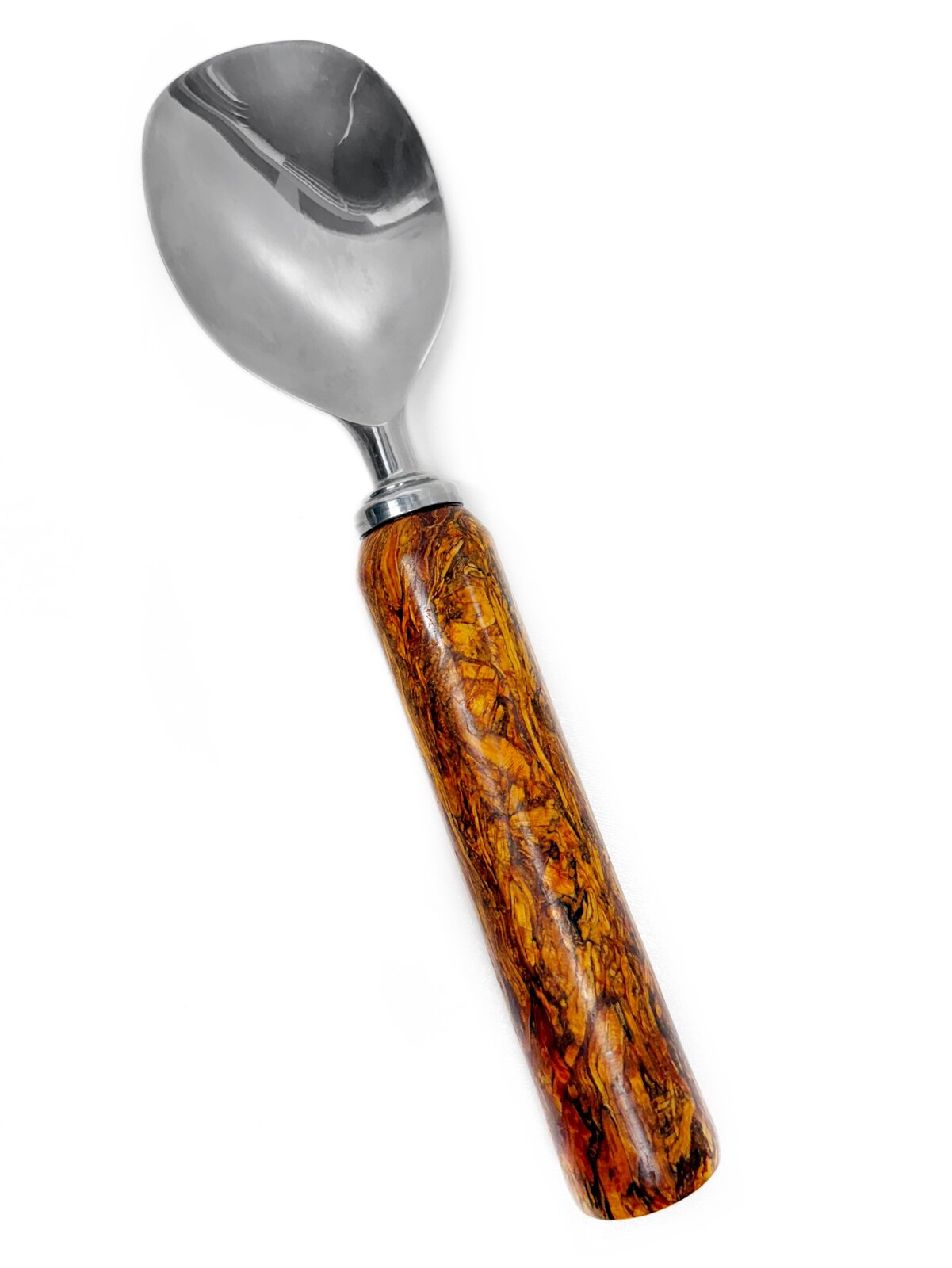

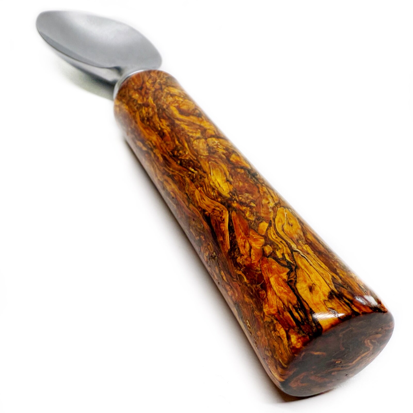

This is the ice cream paddle kit from rockler, but the old version that you have to glue in because it isn't threaded. Not a fan of that style but when I looked at it online it looks like the new version is much better. Oh well!

This piece was dye stabilized orange by my shop - honestly stabilizing is 1000% recommended for HempWood turning. It's fine raw for flat work but stabilizing helps tons for turning. i finished it with a friction polish

I haven't had any issues with strength but like I said I think any of them with a threaded insert are better quality than ones that need to be permanently glued in

I'm very confident in our stabilized hemp - so much so that I offer a replacement if you blow it up. People who struggle with it tend to either try turning it raw or treat it like a typical hardwood. It's thousands of fibers pressed together, so it acts like a combination of wood and fordite
